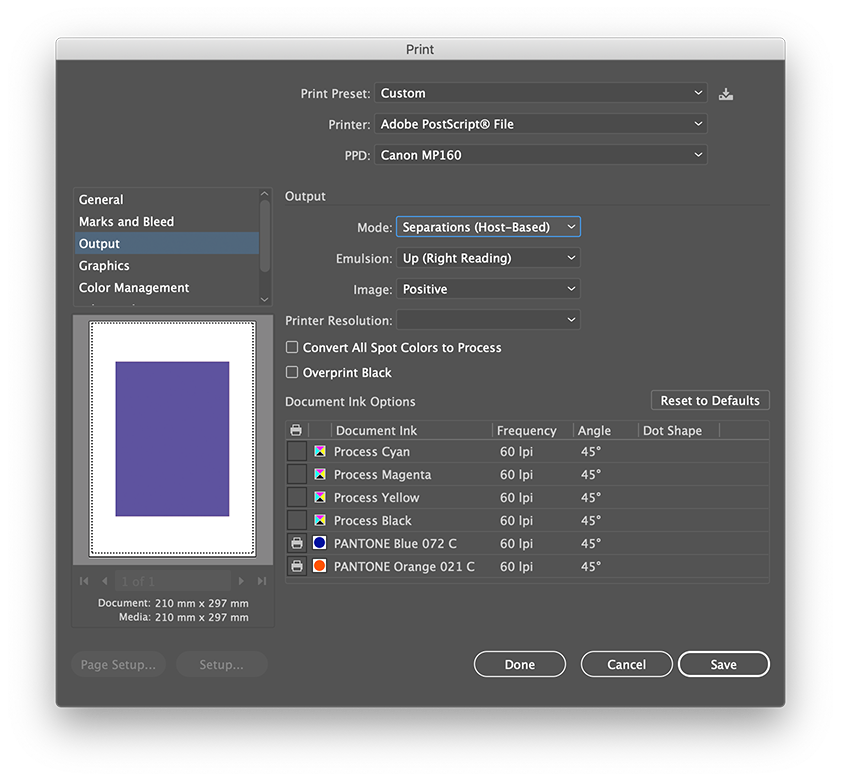

You want to print separations on a desktop printer?
Community Beginner ,
Aug 09, 2020 Aug 09, 2020
yes.
Did you choose a PPD after selecting Adobe PostScript file as Printer?
When I did that the options were device independent or other.  When I chose device independent, it was still grayed out.  If I choose other, what do I select? Thank you

Did you unzip the file and select the ADPDF9.PPD?
Works here.
Thank you, thank you, thank you!  I got it to work, finally.

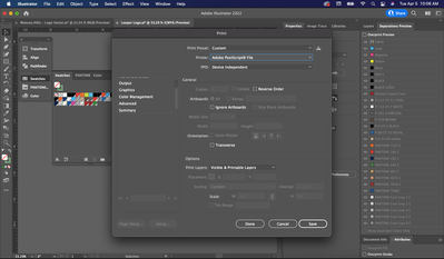

I have tried this and I am getting the same error the PPD is invalid or corrupt. I unzipped the file saved it in a desktop folder called PPDs, closed out of Adobe and it still isn't working. I am using the newest version of Illustrator. Any other ideas? Thank you!
New Here ,
Apr 05, 2022 Apr 05, 2022
I am having the same problem in Illustrator as well as tried to follow these instructions for the PPD and is invalid or corrupt too. All my printer settings are grayed out and I am unable to do anything. Need help!
