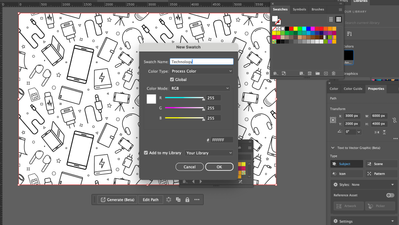

Hello community!
When trying to save a pattern in Illustrator and going to use it from the Swatches > User Defined section, they either show empty or they show plain colors.
Method I use to save: Open the .ai pattern in Illustrator > Swatches > Save Swatches .
I am not sure what I am doing wrong. I tried a couple of patterns and it worked, but after that no pattern that I save using the same method is saving properly.
Could you please help?
Thanks!

I downloaded it from Adobe Stock in .ai format. After the download, it opened directly in Illustrator and then I did this: Swatches > Save Swatches > selected the Swatches folder.
This is another example:
And when selecting the pattern the swatch window on the right does not show the pattern, it shows plain colors and a random pattern. If I proceed to save it as mentioned above, it either saves it blank or saves what you can see in the window here, that has nothing to do with the actual pattern. I am quite confused.
I am using Illustrator 2024 on a mac Sonoma 14.2.1 (23C71).
Thanks!

If it is a real pattern, you could try the following.
With the object that is filled with the pattern selected, click the + button in the Swatches panel.
Name the pattern and it should be added to the swatches.

Sorry, nothing seems to be working.
The "pattern" saved is the 4th box and it is just white.
It seems blank when I save it like this.
And the problem happens with all patterns, not just this one. I tried downloading a bunch and all have the same issue.

That one just contains the artwork. You first need to make a pattern from it. It has 4 repeats on the artboard, you only want to use one of them. Use Object > Pattern > Make.
But beware! It is very complex. 700000 points. That is pretty detailed for a pattern. Most of the detail will probably not be visible when used in small scale.

That was the issue, I was not making the pattern properly from the original file. Many, many thanks for sticking with me!
