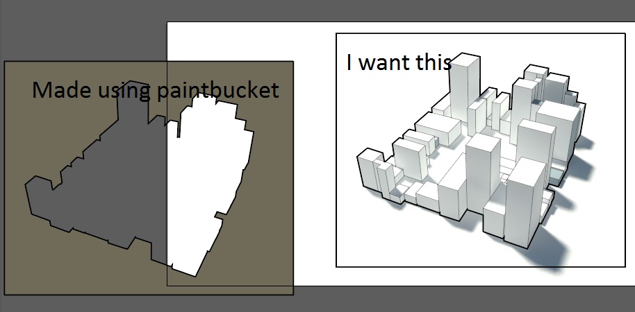

I made this effect in illustrator today (the one on the right). The shadowy rectangles are jpegs renders and the linework is pure vector pasted above the jpeg. However, I used the paint bucket tool for this composition to get the outer profile to make it thick then did the effect.

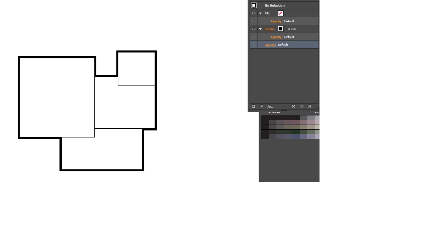

However, if I draw some rectangles in illustrator, do a grouping, apply a new stroke in the appearance panel, drag it down the contents name, I get the effect. This however wasn't happening in the first image scenario where I have lots of blocks, the new stroke applied to the group was getting applied to all the lines and not the outer profile which is my requirement. The lines of the cuboids and cubes are all strokes, simple strokes without any fill.
In the rectangular composition creation, I also met two conditions, one with contents option visible, a
and one without.
I want the outer profile method to work every time. What should I do?
While making the outer lines as thick, I do a grouping

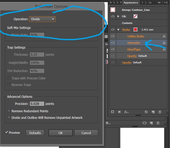

Here is the cuboids one file
Nov 17, 2016 Nov 17, 2016
I've uploaded a sample file that includes one (graphic style) way to do it.
stroke_around_cubes.ai.zip - Google Drive
AI CS5 format, ca. 100kb

No, Larry, Jacob's suggestion won't work in that case.
It's a bit more tricky and you have to do a bit of pathfindering (see graphic style 'contour_line' in my sample file).

Kurt sir, please elaborate the steps, I did see the various components within the style but couldn't figure out your magical spell.
Nov 18, 2016 Nov 18, 2016
Can you explain which part you didn't understand?
Basically, it's just a combination of three effects applied to an additional stroke.

Nov 19, 2016 Nov 19, 2016
Did you already try and apply the pathfinder and the outline stroke effect exactly as in the example file?
It's just important that in the end you appearance panel looks the same and then it should just work. It doesn't matter in which order you selected the effects from the menu. You can reorder them later by dragging them around in the appearance panel.
There's only one exception: in case you're using CS6 there's a bug that keeps them from working when dragging them around in the panel in certain ways. It's kind of difficult to describe what doesn't work.
Which version do you use?
As per your screenshots I guess it may be just an issue at the language level.
When you use an english version of Illustrator and open a file with appearance sets that were created in a non-english Illustrator version, some items in the Appearance palette are not being translated immediately by the application.
Usually it is sufficient to click them once in order to open their corresponding dialogs and hit the OK button. After that they should appear in English. Then you may redefine the graphic style, but that's not really necessary.

I am using cc 2015 version. I group my artwork, apply a new stroke to the group in the appearance panel, drag it down below the contents box in the panel, I then.....
1. add the effect - pathfinder - divide
2. then  pathfinder - add
3. then pathfinder - outline.
Then , I position these three in various orders to get what I want but it doesn't work out. Please help.
Don't use the Outline Pathfinder effect. Use the Effect > Path > Outline Stroke effect instead.
Then it should work.
