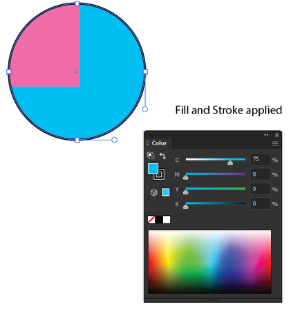

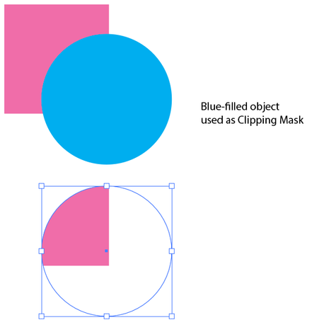

You can sample color from the clipped object from an area that is revealed; however, if the original vector shape that was used to create the mask had a color applied, then you won't be able to select that color. Once you use it to mask other artwork, it becomes a path with no stroke or fill.

As Myra mentioned, when a Path becomes a Clipping Mask, it automatically loses any Stroke or Fill it might have had. You can still add Stroke and Fill colors to the clipping path by selecting it with the Direct Select tool (white arrow), then assigning Stroke weight/color and Fill color as desired.
