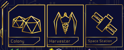

When I exported these files to PDF the line weight of just a few boxes got messed up.
Before (in Illustrator and exported as PNG):
After (saved to PDF), note the 3 center boxes:
The line weight used throughout all boxes (including 1 and 5) is 3pt

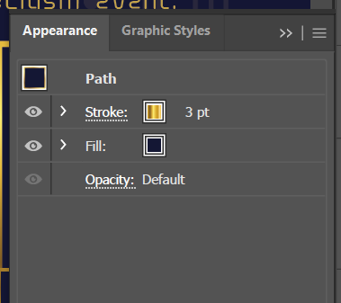

Can you select the path that has the line that is OK and the line that is not OK and then open the Appearance panel with each of them and take a screenshot of each of them?
Community Beginner ,
Nov 09, 2023 Nov 09, 2023
So sorry I am mostly self-taught, if this isn't the panel you're talking about let me know. They appear exactly the same. The only thing that changes in the properties panel is the x-value.
Good line:
Bad line:

If Ton's answer doesn't solve it, can you please check if there is something inside that stroke in the Appearance panel (click on the little arrow)
