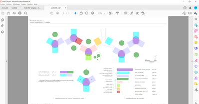

Yes I have tried it before and it still wouldn't work. Which is really odd because I have another drawing with the same line weight and oppacity-color style, but this latter one saves perfectly as a PDF. See the picture below.

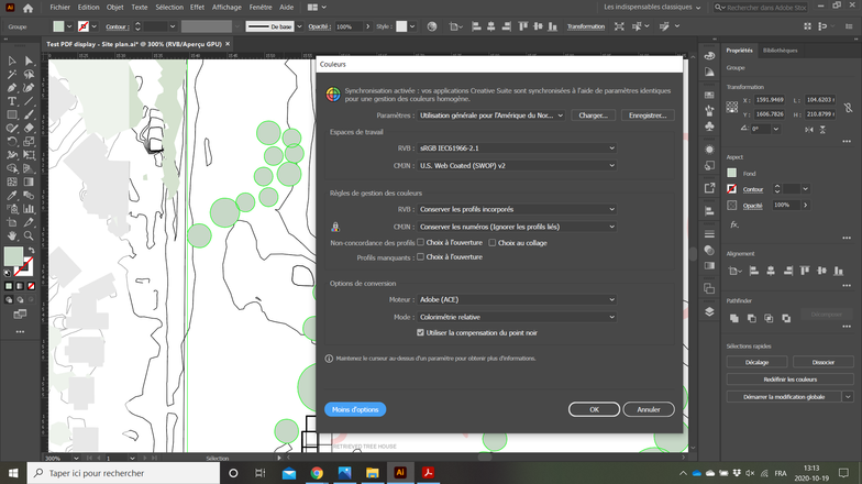

I actually can't tell whether the lines appear thicker or darker on PDF, and I now realize that I gave all of them the same thickness on .ai (0.15 pt) but they seem different on screen on Illustrator.
As for the spot colors, I'm not sure whether I went under the right tab, but when I clicked on Edit > Colors, here's the window that pops up (I apologize, it's in French):
And at last, I don't know whether I'm viewing my ai. file with the overprint preview on.

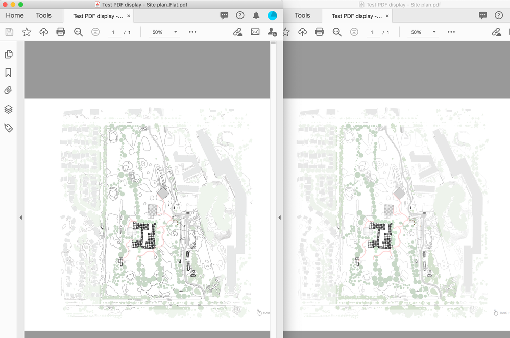

Oct 20, 2020 Oct 20, 2020
Thanks for uploading your files.
All line thickness is .15 pt. as you mentioned. There are white shapes set to 60% opacity over some objects, causing the lines to appear thinner in some areas. When zoomed in, the Illustrator file and PDF look fine. Acrobat is enhancing the line thickness when the preference is on, you can see this clearly when the PDF is zoomed out (50%) (screen shot 1, original PDF is on the right, flattened PDF is on the left). If the PDF is flattened and the strokes are converted to outlines, the enhance line thickness does not occur in Acrobat, regardless of preference. (screen shot 2, enhance thin line preference turned off)
