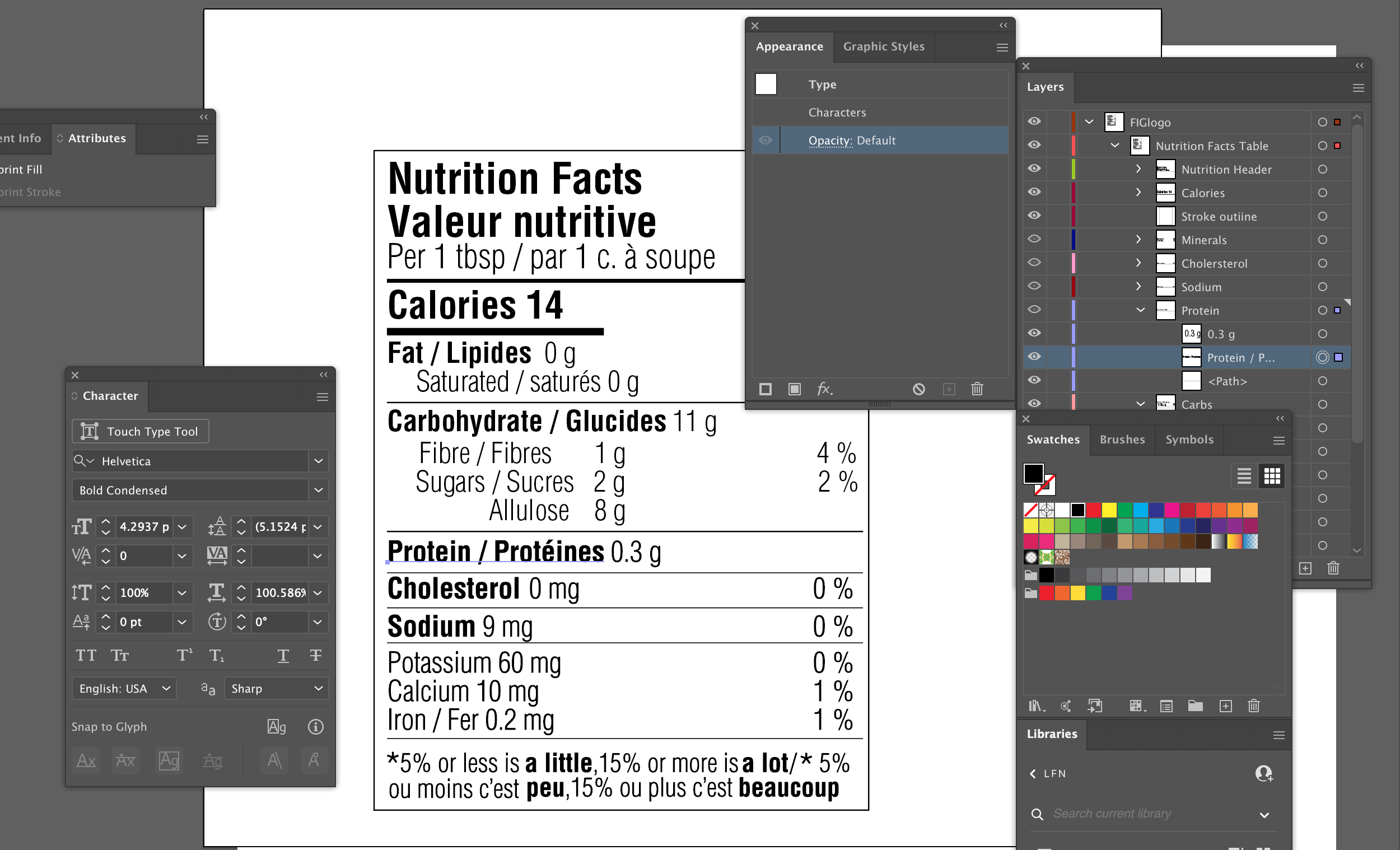

I've got my illustrator files ready to print and I go to create outlines and some of the text appears keylined, while others are fine. Settings text that is fine and ones that are not are exactly the same. I'm at a loss on how to fix it & have no idea why/how it's happening. I've attached screenshots of before creating outlines and then after. Help.

I'm not sure I understood your instructions but regardless the problem was not solved (the source of my issues). I put the nutrition table in a separate document and took screenshots. That document is also enclosed, though I had to save it as eps, as the forum wouldn't allow me to post the ai file. I've been using the nutrition templates for some time - they come from Health Canada as InDesign files & this just started happening.  Thanks

Please show another screenshot with the selected (outlined) text and the visible Appearance Panel.

Can you share a file of that section?
New Here ,
Oct 19, 2021 Oct 19, 2021
Thanks - I uploaded a file that has the nutrition table that is causing all the problems.
Found the problem.
You have some sub-layers set to Outline Mode, so despite the fact the main layer's visibility is set to Preview, the sub-layers keep what they've been assigned. The file is fine and would print okay, you are just not seeing the Preview of the affected sub-layers
