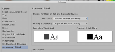

OK, I, uh, maybe found my own answer about blacks changing to CMYK. Hiding down at the bottom of Preferences (not in Color Settings):
Looks like the default is to use Rich Black for both screen and printing/exporting. I just changed mine. I will ask my freelancer to check her settings! The version problem will probably always be with us. I thought that once I caved and started renting CC, that problem would go aways. My freelancer has CC, but perhaps stuck back a version or two - maybe she no longer has a live subscription. Another scheme by Adobe to keep everyone paying.

The Appearance of Black does not change the values in your document.
Only conversion from one profile to another changes the black in a document.
What are your Color Settings?
