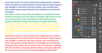

I have a page of text, with each text box coloured spot colour grey 1, 2, 3 and 4, all slightly different tones of grey.. So it is very tricky to see where each grey is used when the page is printed.
I want to run a script or something that will remix all swatches without renaming them, so that those 4 'grey' swatches are each boldly coloured... perhaps one pure red, one blue, one magenta etc. Something to make identifying the usage easy. Is there a way that I'm not finding?

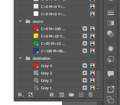

I would create two color groups before running the script, one with your gray colors and another with the colors you want to replace them with. Then the script will replace the color values from the "source" to the "destination" color groups

here you go
// replace spot swatch colors
// CarlosCanto - 1/31/24
// https://community.adobe.com/t5/illustrator-discussions/randomise-high-contrast-swatches/m-p/14381477#M395131
function main() {
    var idoc = app.activeDocument;
    var sourceSwatchGrp = idoc.swatchGroups['source'];
    var destSwatchGrp = idoc.swatchGroups['destination'];
    var sSwatches = sourceSwatchGrp.getAllSwatches();
    var sswatchcount = sSwatches.length;
    var dSwatches = destSwatchGrp.getAllSwatches();
    var dswatchcount = dSwatches.length;
    var swKeep, swDiscard, a, replacementSwatch;
    for (a=0; a<dswatchcount; a++) {
        swKeep = sSwatches[a];
        swDiscard = dSwatches[a];  // discard has to be spot in order to change the colors in the artboard
        mergeSwatches(swKeep, swDiscard);
    alert('Done!');
main ();
function mergeSwatches(keep, discard) {
	var colorkeep = getSwatchColor(keep);
	var colordiscard = getSwatchColor(discard);
	colordiscard.cyan = colorkeep.cyan;
	colordiscard.magenta = colorkeep.magenta;
	colordiscard.yellow = colorkeep.yellow;
	colordiscard.black = colorkeep.black;
	//discard.remove();
function getSwatchColor(sw) {
	if (sw.color.typename == "CMYKColor")
		return sw.color;
	else if (sw.color.typename == "SpotColor") {
		//$.writeln(sw.color.spot.getInternalColor());
		return sw.color.spot.color;
Community Beginner ,
Feb 01, 2024 Feb 01, 2024
Cool! I assume I can add as many colours in as required as long as I update the 'colordiscard' lines?
the script will process any number of swatches as long as source and destination swatch groups have the same number of swatches
