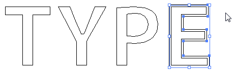

Another way would be to type the live text as you normally would. Then Type > Create Outlines. Select the outlined text and Object > Offset Path. Put in a negative Offset amount.
UnGroup, and delete the outer larger shapes.

Oct 09, 2017 Oct 09, 2017

Thank you so much Barbara, this method seemed to work a treat and the visual aid was very useful too.  Brilliant!
