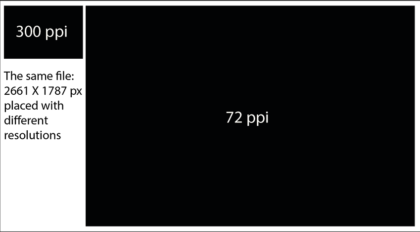

Here is an example, the same number of pixels will place/print at a different size, depending on the resolution setting.
