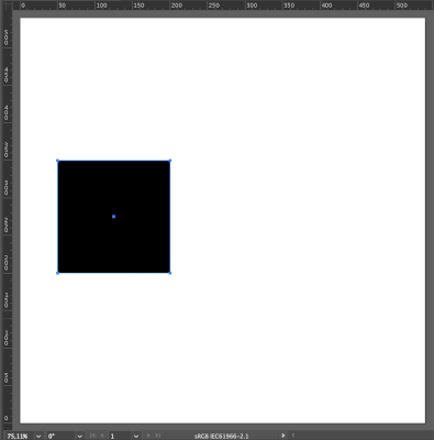

can I change the rulers in Illustrator to match cartesian values - ie positive values are to the right and up, negative values are to the left and down. When I move an object, positive values will move it to the right and up, negative values will move it to the left and down

I see what you mean, the Transform panel works correct, but the Move tool moves the objects up and down when you change both Horizontal and Vertical values.
Dec 02, 2024 Dec 02, 2024
This is what happens with the Move tool after changing the coordinate system, it changes the vertical position when the horizontal value is edited.
