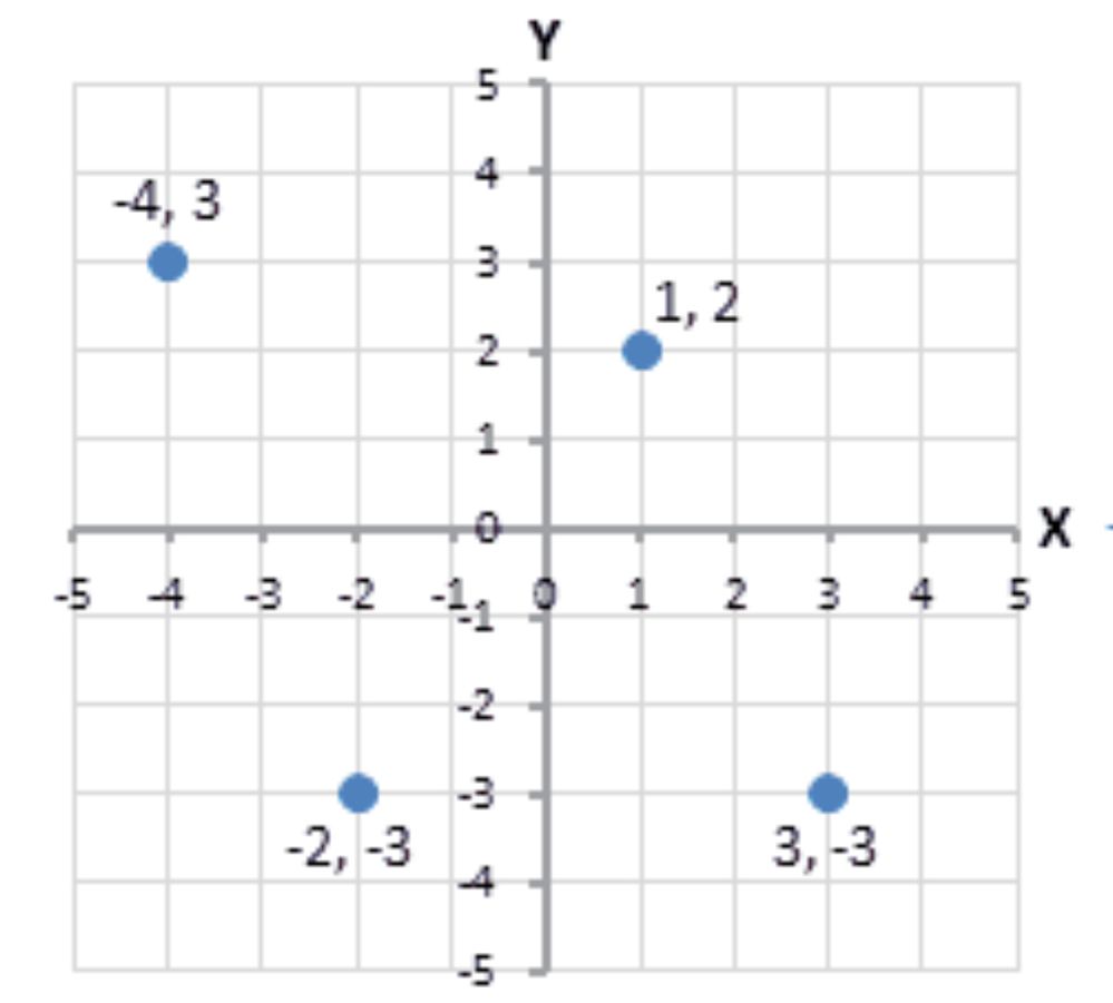

Although it made sense mathematically when Illustrator put the zero point in the lower left, none of the other applications used the upper right (+ +) quadrant, so I guess the decision was made to be like the others.
Some folks complained before the change, and others complained after. I do hope you get your solution and we are still trying to get the older scripts brought back because they are still needed by many.
