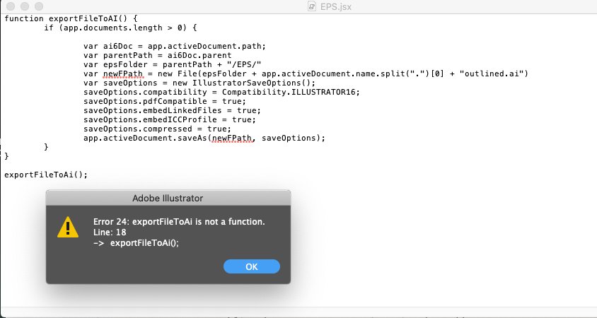

Community Beginner ,
Aug 12, 2020 Aug 12, 2020
Woops...
ok I did add it and i got this
Enthusiast ,
Your "Ai" in the function name at the bottom is not capitalized, ha. It should be "AI". Happens to all of us, but that's an advantage to using an editor like VSCode instead of plaintext
Ok thank you... it worked!
