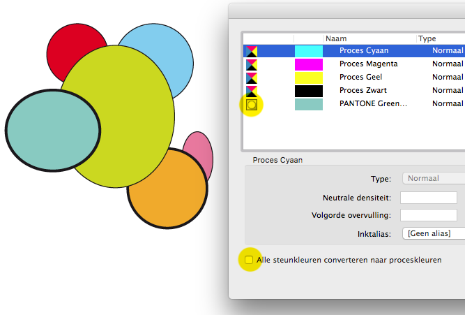

And in case you've already created the PDF including the Pantone inks, then use the Ink Manager in Acrobat to convert them.

Look for the Ink Manager (it depends a lot on your version of Acrobat, which menu or panel to look for, but it's in there, somewhere...)
Adobe Help: Print production tools overview in Acrobat Pro (2017 and DC)
Here it is in Acrobat Pro XI, under the Tools section for Print Production:
Check the option in the lower part of the panel, to convert spot colors to process.

Yes I did this, but i could not save this pdf. I tried to save as and reopen the pdf still it shows the spot colours. I think this option is only for viewing purpose.

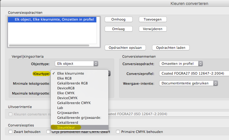

You need to convert the spots in Acrobat using the Convert Colors dialog.
Choose by Matching Criteria > Color Type > Spot Color.
Jun 05, 2019 Jun 05, 2019
Then try using Convert Colors (in the same set of tools) to find any object with a spot color and convert it to process with your preferred profile and method. Below, part of its dialogue (in Dutch).
