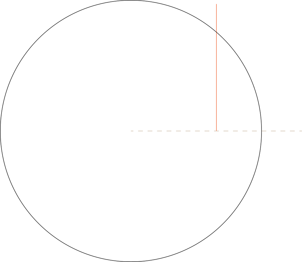

Hey guys,
here you can see my sketch:
I want to make the circle bigger by draging it. I want to make it exactly that big, so that the circle intercepts with the end of the orange line, like the following sektch would show:
I did this sektch by changing the width [px] and height [px] values. But i do not want it like that. I want it to scale up by dragging. The problem: After making the circle bigger by dragging the outer ring of the circle, the position of the center of the circle changes. It does not stay at the same place. Is there any to do this?
Of course i could just change the height values, but i want the circle to overlap with the end of the line EXACTLY.
Greetings Spedex

If you like you can, of course, duplicate the line segment, use the copy for the rotation, and delete when you have scaled the circle.

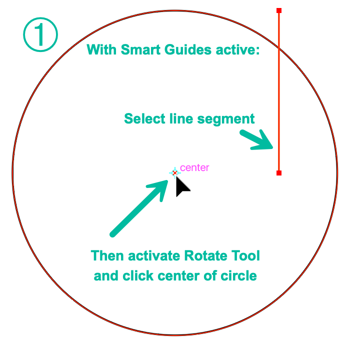

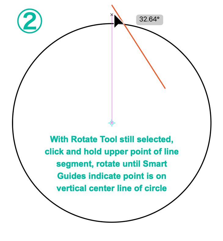

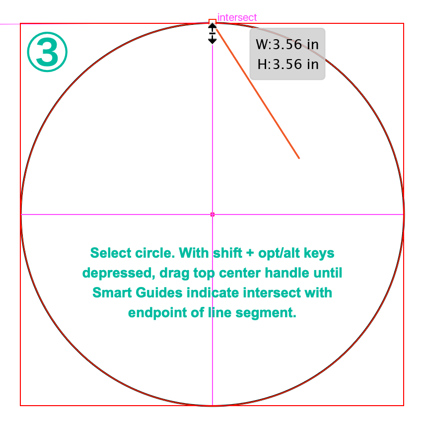

Peter
Hi, Jacob, Carlos, and Kurt!

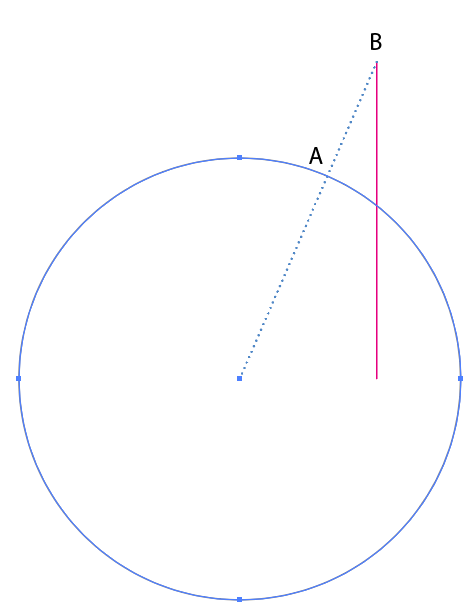

Another way is drawing a temporary guide (dotted line) from the centre of the circle to the top of the vertical line.
Then – while smart guides are turned on – just select the circle, take the Scale tool, start dragging at point A (intersection of circle and dotted line) until you reach point B (upper point of the vertical line).

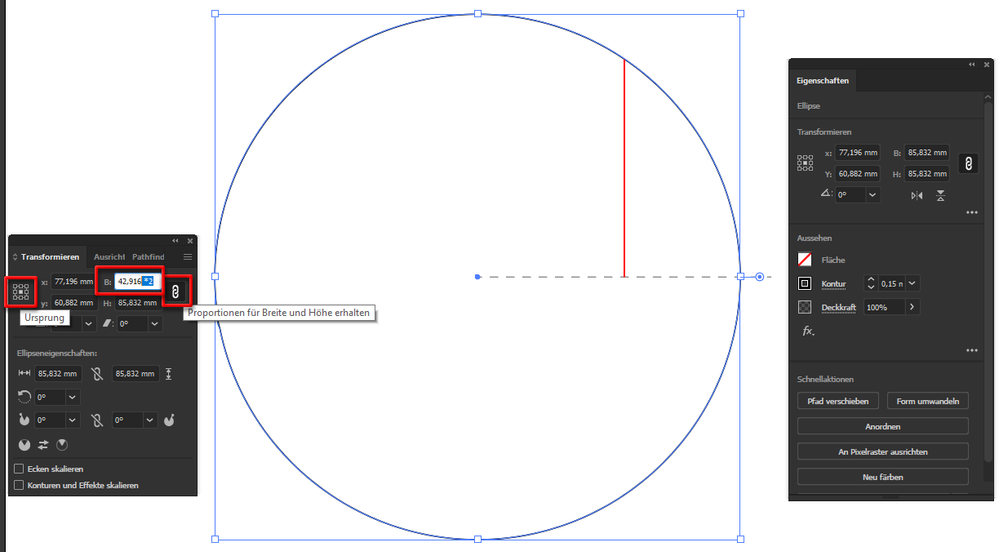

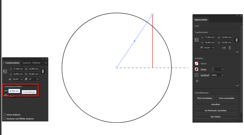

Why so complicated?
Draw a simple line from circles centerpoint to endpoint of your red line.
This is the radius.
select your circle and set the width = radius * 2
Done and
have fun
