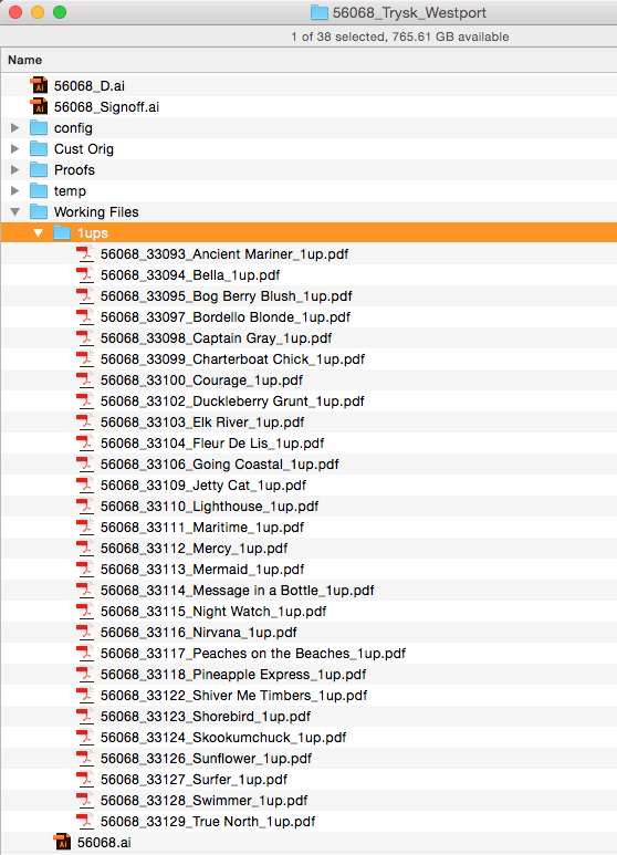

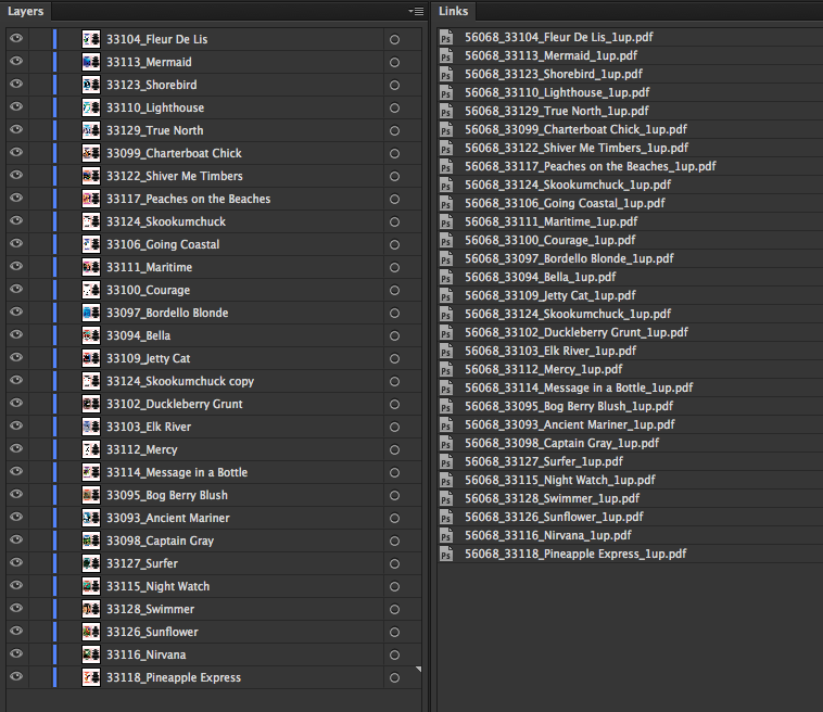

All the images are in the same folder (/Working Files/1ups) and they are either  .ai or .pdf.  When imported, it doesn't matter where they are on the page - all of them can be centered on the page.
I've attached a screenshot of my folder structure (the same for every project) and illustrator layers & links palette.
I made a mistake in telling you that the only difference between the layer name and the links imported is the appended "_1up". Attached at the beginning of the 1ups linked file is a project number that is 5 digits long followed by an underscore.
Thank you so much for helping me with this... I surely appreciate you taking the time and helping! Have a great one.
