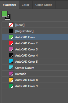

I'm looking for a script that can select a swatch using a specific RGB attribute, then using that RGB attribute - the scrip would change the "swatch Name" from whatever it has been named as (during import) - to a logical name for that layer. eg: "cut" or "crease" or "Bleed" (printing terms).
Background info:
I receive lots of autocad drawings from the same person (NB: Every AutoCad drawing starts from the same template file)
and the swatch colour names seem to be randomly generated from drawing to drawing - when opened into illustrator.
However the RGB colours for each swatch - in every drawing I receive - remain consistently the same
no matter what the assigned (AUTOCAD colour) name is.
During the import process from Autocad to illustrator - swatches are named randomly (as AUTOCAD Colour 1" 2 etc) -
I want to rename the colours to match the layers again. The following (Ideal) swatch names for the RGB values (below)
are what I'm trying to achieve with this script:

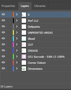

Image of Swatches in document For reference only - Image of LAYERS in the document
(With original Autocad Layer names - intact)
The above Swatch name list can vary sometimes, eg - sometimes there will be more or sometimes less layers.
it all depends upon the print dieline requirements, the layers listed are the main ones used
The Red lines are examples of swatch colours that may be there on occasion.
