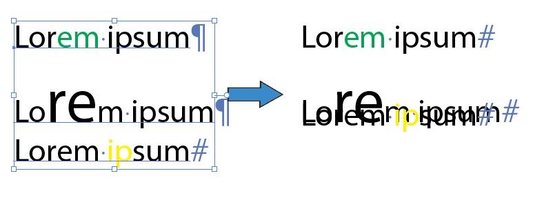

 Check out these great results! The text can be totally arbitrary.
Feb 12, 2022 Feb 12, 2022
Hi Vasily, thanks for sharing!
I get this
Valorous Hero ,
Hmm, maybe something is going on which may throw a wrench into the whole thing.
Do your texts look somewhat like this?
Feb 13, 2022 Feb 13, 2022
yes, it looks just like yours
Valorous Hero ,
Mmm, yes! The script I have created indeed does not do the line-spacing where users can increase it more than the default setting. Maybe due to removing lines, if vertical spacing is default it looks like there is no difference but when there is, the removal of lines does this. With some editing it may be possible to deal with this too.
