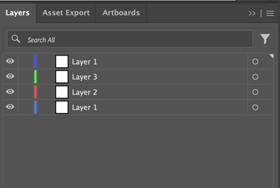

Surely there is a soltion out there but I just coulnt find it. I need a simple script that iterates thru all layers and those with the same name get merge together into a new layer. The original layers end up as sublayers without having their contents comingled or names changed.

Enthusiast , Nov 07, 2024 Nov 07, 2024
New layers with sublayers are created on top of other layers.
// Script to merge layers that have the same name into sublayers

Enthusiast ,

Explorer ,
Thanks brother ... I'll take it from here.
Explorer ,
Nov 08, 2024 Nov 08, 2024
How about a little help with including layers that are locked and hidden and maintaining their status once transferred?
Enthusiast ,
Yes, I was thinking about this case tonightNow the script can transfer only layer contents via confirmation dialog. https://gist.github.com/creold/6ae88e09836400e43a472db4c0973576
