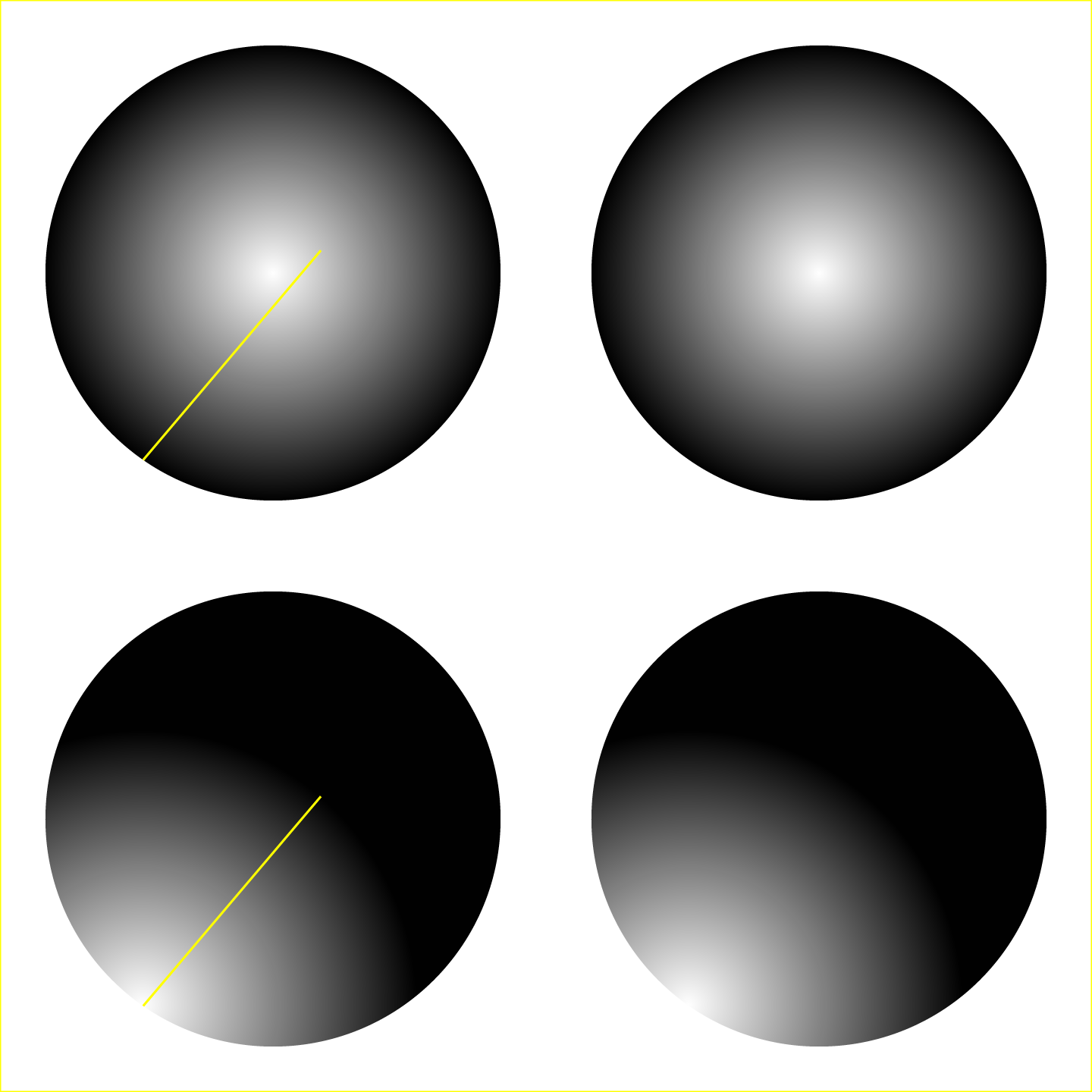

Tim,
I believe that the real issue is the woolliness of gradients, and the preferable feature request might be the option of snapping the gradient (end) points to paths/Anchor Points (with Smart Guides).
Unitl such a feature is realized or till the end of time, whichever occurs first, maybe the least worst approach would be something of the sketchy kind shown below for a radial gradient, (in)accuracy depending on care and zoom level:
1) Create a path (shown as a circle with a radial gradient white to black),
2) Create a guiding line, maybe with the Line Segment Tool which can be snapped to the circle and ClickDragged followed by setting the end Anchor Point position(s) or set to a certain length and angle and then snapped to the circle (shown in yellow, top left),
3) With a suitable zoom level ClickDrag along the guiding line from 2) with the Gradient Tool trying to get the best hit at both ends by eye (shown bottom left).
The corrresponding appearances without the guiding line are shown to the right.
Click to get see in ful if not already, Click again to get closer (still)
