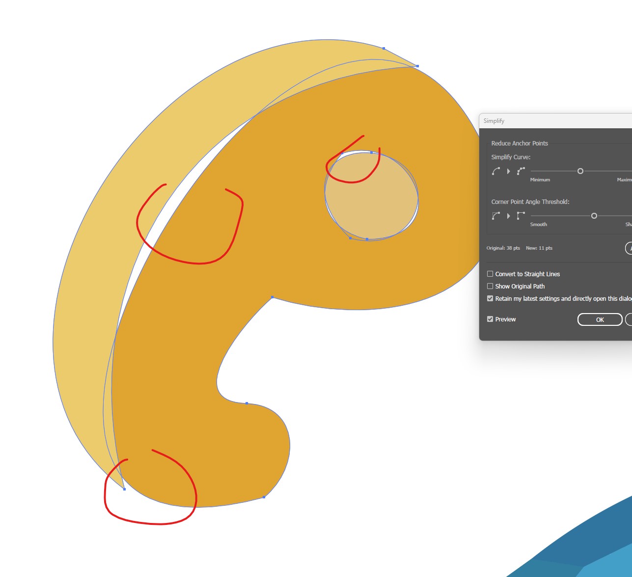

I have image traced a complex drawing, I'm trying to perfect it but am struggling.
I am a total beginner.
In the attached, you can see the 3 objects I am trying to simplify (practising on a tiny part of the whole drawing), but when I use "Simplify...", it simplifies each of them individually, and gaps between them appear.
Is there a way to keep them all connected but only simplify the combined outer boundary?

If you must (work with the image trace as it is), you can try something like this:
1) Working on a copy of the whole set of simplified paths, create a combined outer boundary using Unite (Pathfinder), maybe needing Offset Path (first positive, then negative) to close gaps,
2) Simplify that and use Live Paint to fit the individual boundaries of the original set to the combined outer boundary from 1);
3) Use Live Trace on the simplified inner boundaries to get rid of gaps and overlaps.
You can read a bit more here,
https://helpx.adobe.com/illustrator/using/live-paint-groups.html

Here is a little elaboration for clarity:
1) Working on a copy of the whole set of simplified paths, create a combined outer boundary using Unite (Pathfinder), maybe needing Offset Path (first positive to close gaps, then negative with the same amount to get back to the original boundary size);
2) Simplify that and maybe adjust the outer shape further, then use Live Paint to fit the individual boundaries of the original set to the combined outer boundary from 1);

After spending a few hours trying all the different options, what worked the best for me - was grouping 2,3 areas at a time, simplifying them, and then manually adjusting anchor points to link the areas back to each other and achieve the desired result. It's a bit long, but as I only needed this for this one (yet important) image, it was worth the time.
