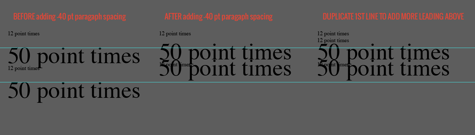

Jan 25, 2017 Jan 25, 2017
In the second column looks wrong as the type did not go up by 40pts, but by about 8 puts. That is because there is not enough leading above the type.
Most people would never set type this way, so we never run across this. Probably best you show us what you are trying to do, as you are making this tougher than need to be. But if you do not post a sample using dropbox (or similar) or provide clear concise instructions,  than I will not be able to help you.
