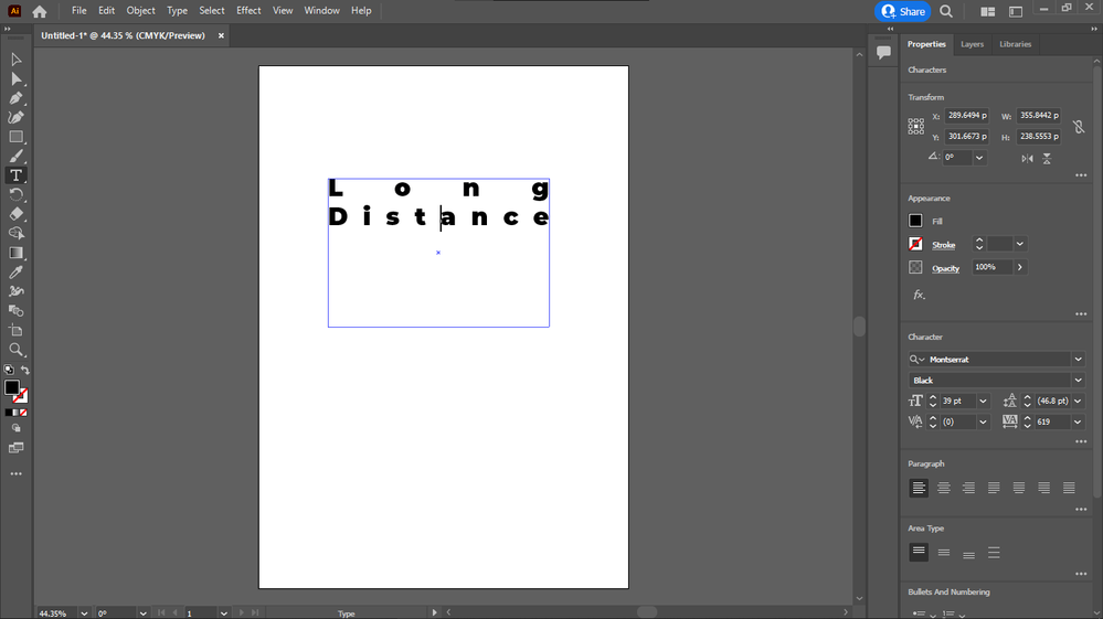

I want to fit words in rectangle shapes with Illustrator (each word is a rectangle but the words together are also a rectangle) with one word in each row so that Envelope Distort would make the text into the selected shape without distorting the font height.
Instead, it should automatically adjust the rectangle height, to fit the text to the width.
In fact, I don't want to allow horizontal distortion of the font either.
And I don't want to allow to distort the tracking (distance between the characters) either.
The only thing I want to allow to the Envelope Distort, is to resize the second word's font until the width of the word matches the width of the first word, and so on.
So only the font size is allowed to change until it matches the width.
And the vertical distance between the words should also be the same, so their frame should perfectly fit the word so I can space them evenly, vertically.
How do I do that?
Thanks in advance.

I just tried Fit Headline.
The font of the upper row should grow to fit the width of the row below.
How do I do that?

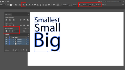

my solution for this (some manual work needed, i suppose it could be automated by a script, but that´s out of my knowledge).
(sorry, my illustrator is in german language and i´m not sure of some of the appropriate english terms and menu commands )
1. Select the text tool
2. type the first word with the desired font, font size doesn´t matter for now
3. Deselect all
4. type the next word, deselect again
5. The same for all the words you need.
6. Convert each of the texts to paths (type-menu -> create outlines)
7. In the layers palette select the group of the first word
8. In the toolbar type in the desired width (with the symbol for proportional scaling checked, to avoid distortion)
9. repeat this process for each of the words (always the same widths)
10. In the layers palette select the groups of all the words
11. In the toolbar klick on align left
12. Keep the groups selected
13. open the alignment palette (window -> align)
14. Click on one of the words: It should look highlighted. In the alignment palette you now should see an input field to input the distance of the disired distribution of the words. Type in the desired distance (e.g. 20px) and click on the icon for vertical distribution.

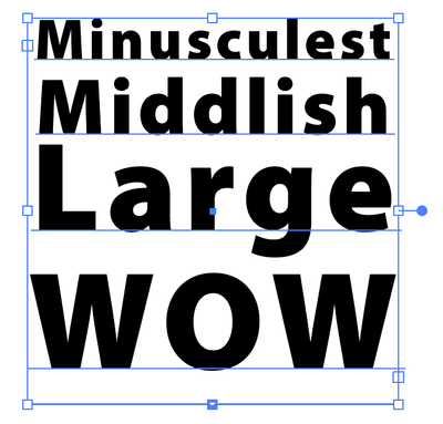

There is a script for this  - does turn the text into outlines, though.
Screen Shot 2022-08-25 at 9.13.09 AM.png Screen Shot 2022-08-25 at 9.13.15 AM.png
looks good with all caps, too
