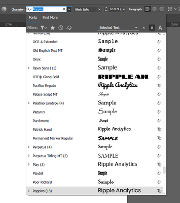

Hi, Hoping someone can help direct me to where I can adjust a setting so that when I am changing between fonts, I can return to the position of the current font in the font list, rather than return to the top of the list. It has only recently changed as I used to continue down the list rather than have to scroll back down through all the fonts to try the next font.

A couple of versions ago Illustrator introduced the feature of "Recent fonts" that would appear at the top of the font list. You can set in preferences in the Type section the number of fonts that you want in this list from 1-15. Since that time the way that the font list works no longer allows for the type of scrolling from where you left off that you have described. I agree with you that I liked the earlier way that it worked better and I have tried to find a way to get it to work the way that

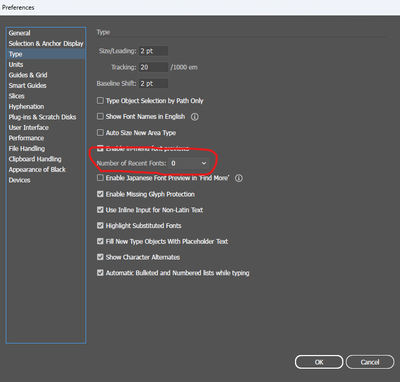

Not sure if you ever figured this out but
Go into Illustrator > Settings > Type...
Change "Number of Recent Fonts" to 0
It should stay where you left off!

Feb 10, 2021 Feb 10, 2021
This worked! I can now click on the text on my page and click the font dropdown and it takes my right to its place in the list instead of back to the top! Thank you!

Instead of clicking on the down arrow in the character box, click on the name and use the up and down arrows to scroll through the fonts. Problem with this though is when you come across a font that doesn't work with what you have written!!!  You have to press that down arrow!!!  At least this will cut out some of the problem.

Also putting recent fonts to 0 in preferences seems to have worked for me!! CC 22.1

It works in Illustrator. I have the absolute latest version. Setting the 'RECENT FONTS' under TYPE in your Preferences allows you to continue where you left off in searching for the perfect font to compliment your design or client's request.

I noticed if you use the down and up keys on your keyboard after selecting any font, it will stay in the area of the last font you were using. Even if I selected the font from the recent selection.

Thankfully setting the recent fonts to "0" and then *restarting* Illustrator seems to have fixed the issue! Though I have found, if a selected font does not have a name displayed in English, then when you click the drop down box again to keep searching it will start back at the top alphabetically.

I am using Illustrator 27.7. I have changed the "Number of Recent Fonts" to 0, and it solved it.
I no longer see a suggested font at the top of the list.

turning it to 0 o recent fonts worked for me to thank you for this tip will be a time saver for sure 🙂

Go to Preferences/ Type, and set the number of recent fonts to 0. That worked for me 🙂
