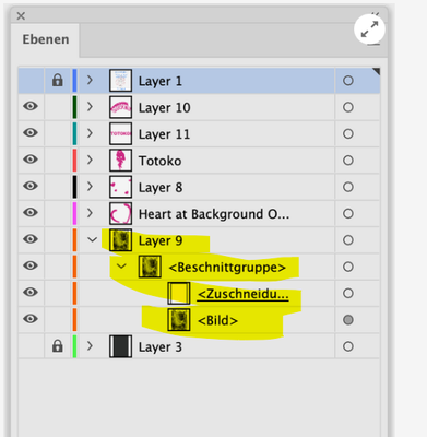

Oct 07, 2022 Oct 07, 2022
The image still was inside a clipping mask, which was unnecessary.

Oct 08, 2022 Oct 08, 2022
This might happen when you copy and paste images from Photoshop (or other) into Illustrator. So to prevent it, save the image file and then place it in Illustrator (File > Place)
To get that image out of the mask you can also in the layers panel just grab it and then drag it out. Afterwards delete the mask using the little trashcan in the panel.

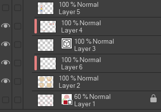

Hm that's werid though cause the og image on how I created the compound lines were made in Adobe Illustrator. The only thing (minus the texture) that was not created in the program was the sketch as the top. I traced over the image in question with the pencil tool, punched holes though the process with the Path/Divide Objects Below situation and then just hide the sketch and it was the result. Usually with clip studio paint (will show you an example here:
Components in the image:
The parts highlighted in this image is the clipping mask situtation that I want to learn in Adobe but struggling on how to do. There's stuff like this link here: https://helpx.adobe.com/illustrator/using/clipping-masks.html but it seems like it's mainly with shapes. Would the part to add the shape to mask the item, would the user have to recreate the silhouette to get a perfect copy of the mask?
I'm sorry I don't understand your question.
I was just referring to that Pixel image you highlighted in my screenshot. It has its own unnecessary clipping mask applied. And this clipping mask was probably throwing off Illustrator.
When you open a file from another application or paste something into Illustrator, always first open the layers panel to analyze it and then also get rid off everything that is unnecessary before you proceed.
