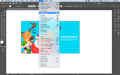

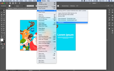

If that's just a display need, You could use Proof color:
1. From the View menu choose "Proof setup > Customize > Dot gain
2. Turn off and turn on Proof colors
3. If you need, you could assign a shortcut by Edit menu > Keyboard shortcuts
Proof setup.pngSet color proof.pngProof colors on.pngEdit Shortcut.pngProof colors off.png
Participant ,
Jan 16, 2020 Jan 16, 2020
Awesome, thanks! Happiness is a fact 🙂
One problem occurred:
When I close Illustrator and opens it again, the custom Proof Color needs to be selected again (then the shortcut works again). Is there a way to save this setting so it's always there once Illustrator is started?
Do correct me if I'm wrong here: dot gain seems to be for printing and if my artwork will be used in an online video, sGrey is a better option. I personally don't see any difference, yet I thought it would be good to talk about it for future people reading this thread.
