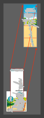

Hello Anubhav,
thank you for your comment. I'm attaching a screenshot here: you can see the word "Stop" and its bounding box displayed in the bottom left (an empty box). The numbers in the top right were all assigned to the scales and have all been moved. The text in the locked layers is also shifted.

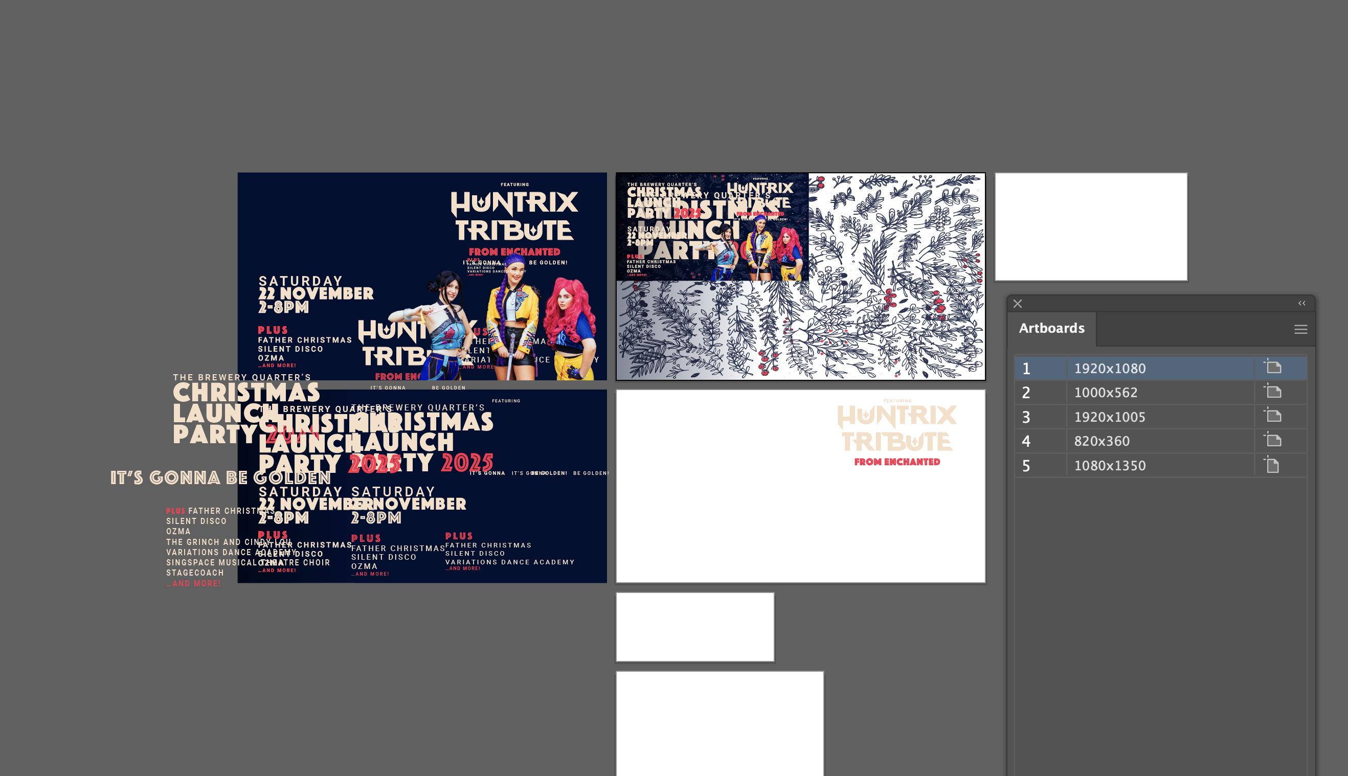

Oct 14, 2025 Oct 14, 2025
I'm getting this far too regularly and it's proving to be a pain. Last week it happened on a massive job with multiple artboards and took hours to put back. Attached is a grab of one that happened this morning - relatively quick fix in this instance, but it's happening too often...
