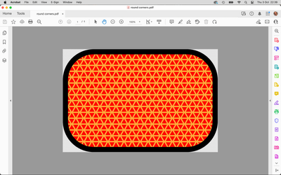

The PDF does not have white in the corner (unless you added a white recangle in Illustrator as background).
In Illustrator: View > Show Transparency Grid
In Acrobat: Preferences > Page Display > Show Transparency Grid
Try it out by placing the PDF in Illustrator on a colored background.

Printers do not print what is not there. There are no white corners in your PDF (did you check View > Show Transparency Grid?). They won't print white (unless you pay them extra for the additional white ink).
Talk to your printer.

@Ericajv987654321 I will have to agree with @Ton Frederiks! When you print this, as long as you didn't add a colour white background to the artboard, and if you look at the attached image from @Ton Frederiks it is a transparency, which means, what you see is what you get...which means, the white corners will not be printed.
If you truly still don't trust the process, go ahead and print on coloured paper, and you will see that it isn't there.
