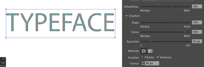

LEGEND ,
May 19, 2012 May 19, 2012
There is no centerline trace in AI
Yes, there is:
It's result—like autotracing in general—is often crap, but you can trace as centerlines.
This is CS5, as specified in the thread post. I have no idea yet whether this has improved at all in CS6.
JET

AGAIN, Wade, the original question is specific to CS5.
Centerline traces are done by turning on Stroke, turning off Fills. The tracing algorithm tries to match the resulting open paths' stroke weights to the thickness of the pixel areas it tries to follow. You don't have to delete "the a pathe on top of another path"--whatever that giberish means. The screenshot I posted is from CS5 and shows the unmodified raw results. The paths are open paths and I did not delete any paths.
The key to it (for those here who can actually listen) is to understand that the Max Stroke Weight slider does not refer to the stroke weights of the resulting paths. It refers to the "thickness" of the pixel regions that are to be treated as strokes during the trace. Carefully read the tooltips that appear when you mouse over the various sliders.
So no, it is not limited to "very certain fonts." It is, of course, not limited to "fonts" at all, because autotracing doesn't know didly about "fonts." It just sees pixels.
The centerline functionality has been there since the beginning of the LiveTrace feature. It's interface is cumbersome and unintuitive crap; and one's time is better spent drawing the centerlines properly. But centerline autotracing functionality most definitely IS included in this poorly executed, overblown autotrace feature.
Again, I have not yet installed CS6 and taken a look at its rework of this hideous feature. So I don't yet know if it is better or worse; or whether its functionality has actually changed or remains the same with merely new window dressing and simplified UI. (The marketing hype claims it has been rebuilt.) But the same checkbox set is obviously still there:
So my guess would be that the same or similar functionality is, too. An autotrace feature without centerline functionality would, after all, be exceedingly lame.
(This checkbox set would be more accurately labeled "Open Paths" and "Closed Paths", or "Trace Around Shapes" and "Trace Along Centers", or "Outline Mode" and "Centerline Mode" [if the options were mututally exclusive, which they are not] or some other such, since "Fills" and "Strokes" is counter-intuitive, given the program's own terminology. Fills and Strokes can, of course, be applied to either open or closed paths.)
My only reason for posting in this thread is to correct the repeatedly-stated misinformation that there is no centerline functionality (i.e.; open path tracing) in LiveTrace. There is, and always has been. That doesn't mean I recommend it for this purpose. I don't.

May 20, 2012 May 20, 2012
It still works in CS6
http://www.vektorgarten.de/img/tut/centerline-trace-cs6.png
