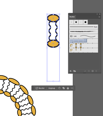

Sorry, but the offset path doesn't work. Even changing the offset path parameters, my stroke is always in the middle of the brush. Pretty annoying since my brush is semitransparent (yellow circles and "sticks" in the figure).

Oct 13, 2023 Oct 13, 2023
If you drag a brush out of the brushes panel you will see an invisible box in the back.
Try moving the box up or down to change the brush position on the path.
Drag it back to the brushes panel to test.
Offset path should work fine on a closed shape. For open paths, I would build your brush like this:
So there's a no stroke/no fill rectangle double the height of the artwork.

Dec 20, 2024 Dec 20, 2024
This is such an simple and clever solution.  Worked perfectly, thank you!
