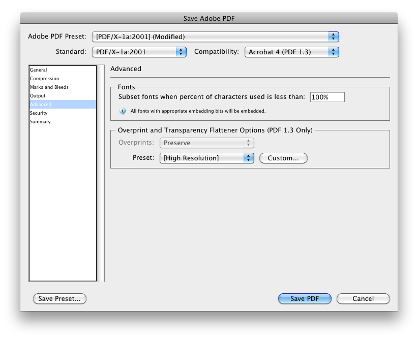

If, however, you are saving a PDF for a printer and they reqire flattened artwork, you can take care of that on save. I suggest you use File > Save A Copy, choose PDF, then make sure the Compatibility is set to “Acrobat 4 (PDF 1.3)”. This version does not support transparency, so requires artwork to be flattened. In the Advanced panel you can choose te flattener preset Illustrator will use and, if you wish, edit it.
Illustrator will then save your file as a PDF with all artwork flattened. If you used Save A Copy, then the original Illustrator file is unaffected and your transparency effects are safe.
