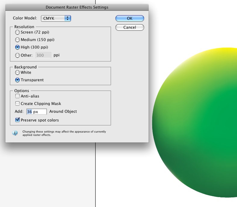

LEGENDE ,
Apr 22, 2009 Apr 22, 2009
Try looking at you Raster EffectPicture 2.pngs settings and look at the add around setting in particular and the anti alias setting in creasing the add around setting may eliminate those lines.

Engagiert ,
Thanks for the quick reply. Unfortunately, my lines are still present. Me and my coworker have been testing settings all afternoon. The only thing working so far is a deliberate removal of the shadows. That seems a bit harsh though. That, or flatten everything to a TIFF, which too seems extreme.
