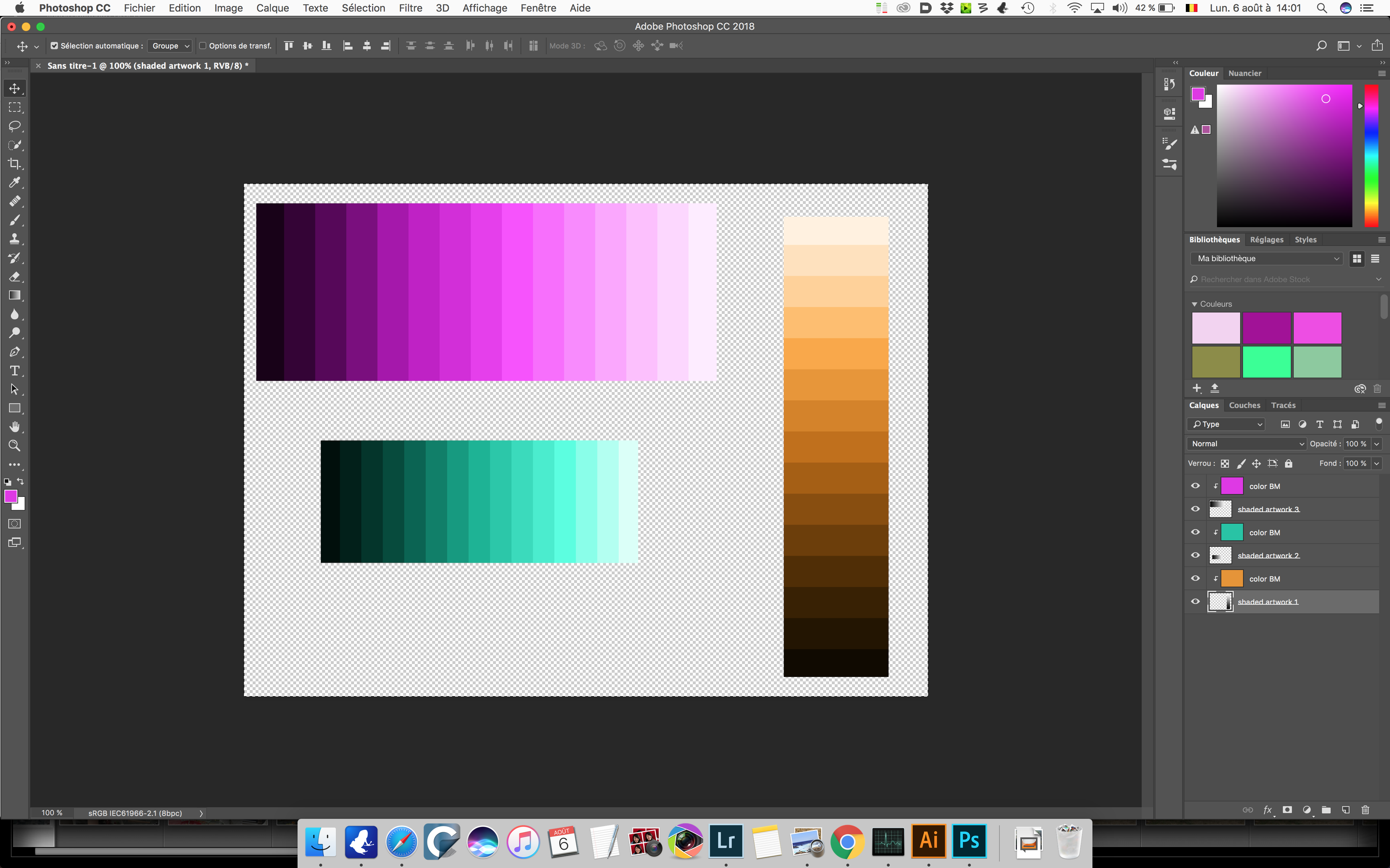

So I my original intent was to do it like I would in Photoshop, clip a plain color layer (in color blend mode) to each corresponding area of my shaded B&W artwork.
See attachement for example in Ps.

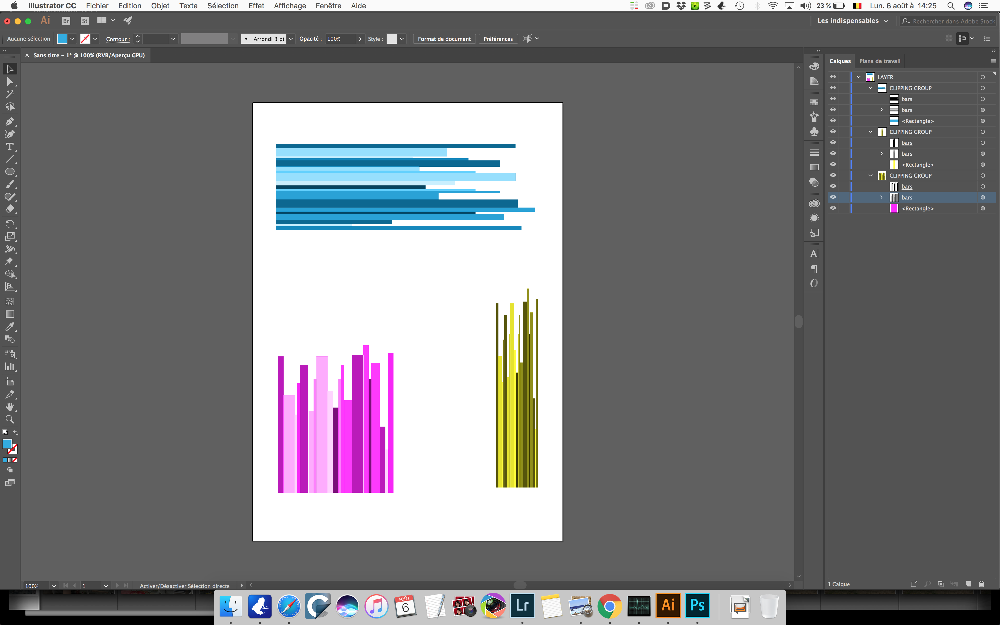

But since Illustrator does not quite operates in the same way I ran into the following problem.
I tried to create a clipping mask from a group of shaded rectangles clipping a plain color rectangle. But illustrator does not allow you to do that. So, to get a clipping mask with the group's overall shape, you need to transform the group into a compound path and then apply it as a clipping mask. But this transformation from group to clipping mask throws away any shading you had within the group, making it basically a transparent path. Now if I use this path to clip the shaded artwork that is blending with the plain color layer (in luminosity/color mode), sure it works and I can get to the effect that I want.
BUT the problem is if now I want to make adjustments to the shaded B&W shapes (there are a lot of them), I need to do it TWICE: on the shaded shapes and on the corresponding clipping path that I need to re-create too !!! That does not happen in Photoshop since blending modes can interact between the clipping layer and the clipped layer.

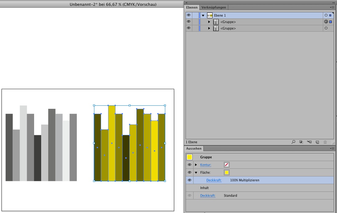

Maybe I was thinking too simple, but I just made a group of the B&W columns and added a new fill color to the group and set it to multiply.

I tried that option as well because I know there a clipping option there. I tried every other option included in that dialog box. Unfortunately, as I suspected, it didn't work either 😕
An opacity mask does not do the same thing. Where there's a dark shade, it hides more the color already there. That's not coloring different shades of a shape.

Haaaaaa q3player
How could I not think of that !!!
This is of course the very proper and simple solution : a new fill color to the group with a custom blending mode for the fill itself (albeit the proper mode blend mode is then color, to blend the fill color with the shapes luminosity).
Not only no plugin is needed, but I can still also use my swatches as a reference and with global colors for easier grouped tweaks !!!!
Stupid me ! THANK YOU for your clairvoyance q3player !!
