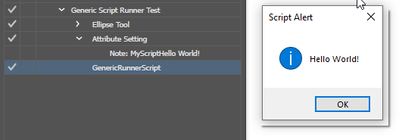

function genericRunnerScript () {
	var doc = app.activeDocument;
	var firstSelectedItem = doc.selection[0];
	var itemNotes = firstSelectedItem.note;
	firstSelectedItem.remove();
	var itemNotesSplit = itemNotes.split(/[\r\n]+/g);
	var scriptName = itemNotesSplit[0]; // MyScript.jsx
	var theScriptArgument = itemNotesSplit[1];
	eval("#include '~/Documents/Adobe Scripts/" + scriptName + ".jsx'");
	eval(scriptName + "('" + theScriptArgument + "')");
genericRunnerScript();
Here is an action that would work with this script:
And what does "MyScript" do? This script is different because it's actually just a function, the purpose of it is to be called from a parent JSX script (the generic runner) by using the eval statement to create the function call. It just alerts its one argument.
function MyScript (sampleArg) {
	alert(sampleArg);
And, we still get the alert box with an argument which was passed by the action to the generic script and then to the specific script.
