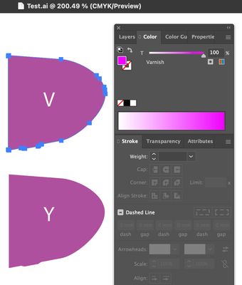

Yes, thank you, because the vector artwork is being sent to the printer as a bitmap by Illustrator.
It is a CMYK document and the colour is a spot colour:
It will not send the file without 'Print as Bitmap' option being enabled, even when it is unchecked.

Jul 18, 2023 Jul 18, 2023
Halftone screening is normal for a PostScript enabled device.
This is not bitmap. It's halftone screening.

How do I get the pink spot colour to print as a solid when output, instead of a halftone estimation of the colour?
Are you able to replicate the situation where the 'Print as Bitmap' option is unchecked, but, the print summary states 'Print as Bitmap: On'
Community Beginner ,
The pink spot ink as a solid separation on the film, so to speak.
For that you need to print separations. Your printer driver needs to support that. In the print dialog go to "Output" and there you can select to print separations. If it's not there, then your printer driver doesn't support it.
