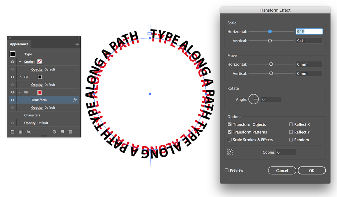

Aug 03, 2018 Aug 03, 2018
Something like this?
Ton,
That was almost what I thought when I wrote the first post, with the added option of rotating the shadow path type (which can be done with your way), and keeping it the same size.
Harvest over here, earlier than anyone can remember, and heat has lifted a bit, at least until Wednesday which may prove to be the hottest.
Without a good example picture, we keep guessing.

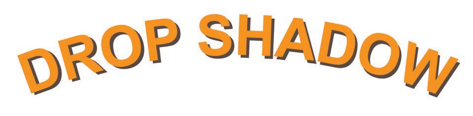

Here is an example of the problem drop shadow. The straight drop shadow is evenly down and to the right.
The curved type shadow is not. I had been trying to upload an image with the link icon instead of the insert image icon!

Community Beginner ,
Dec 08, 2018 Dec 08, 2018
Here is the curved drop shadow without having to outline and manually position. I used the rotate tip and also scaled down the drop shadow on center and the produces a very even drop shadow.
Thanks for the help.
For my part you are welcome, Mike.
Your scaling the drop shadow down just the right wee bit is a crucial part.
Thank you for sharing.
