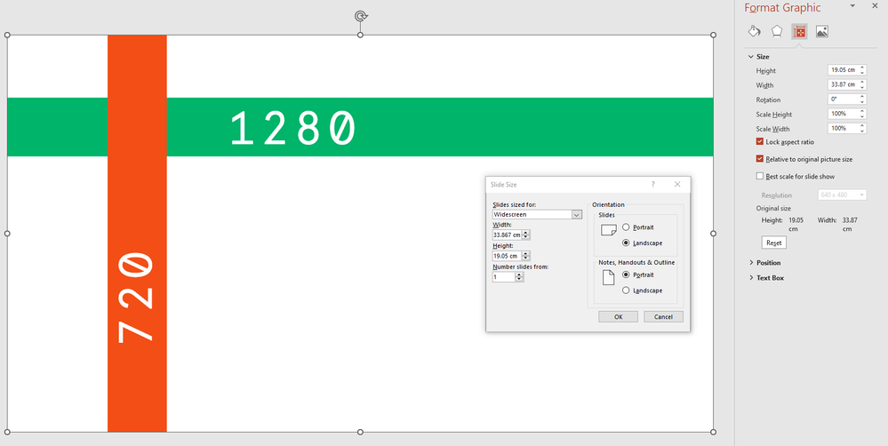

Oct 28, 2022 Oct 28, 2022
This is a 1280 x 720 px artboard exported from AI as SVG. Seems to come in at the exact slide size. Can you share a demo PPT file?

If I use Paste Special > Enhanced Metafile, I get the same result as you (an image 45.19 x 25.43, which is 1280 x 720 @ 72 PPI)
If I use Insert > Picture and then choose my SVG, I get an image the same size as the slide.
I tried again with a group 960 x 540 and got the correct result, which makes sense as that is 33.87 x 19.05 @ 72 PPI -- but then I don't understand why you didn't get the correct result to start with in that case.

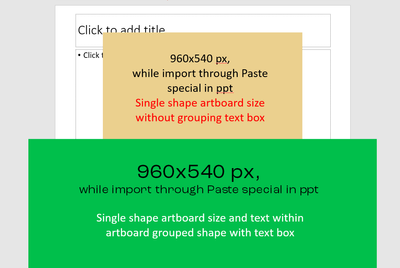

Nov 01, 2022 Nov 01, 2022
Yes, but didin't match the exact size, below is the result
