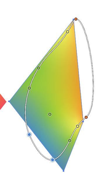

This is the original shape of the gradient
and how it changes after I select the two objects together.
Changes vary slightly depending on the colors of the original gradient. Sometimes there are drastic changes of color, sometimes drastic changes of gradient shape.

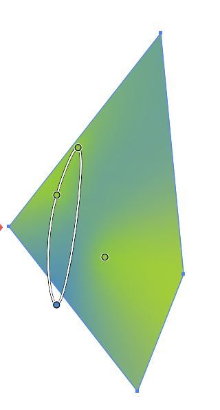

It might have something to do with the colors used.
If I copy and paste one of the objects that is not changing, and alter the colors to these ones that are affected, then suddenly it will alter if I select the object with another one.
If I select an object that usually alters with a copy of itself, it does not change.
But the instant I select either or both object(s) with any other object, the change occurs.
