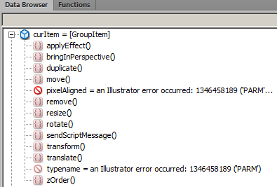

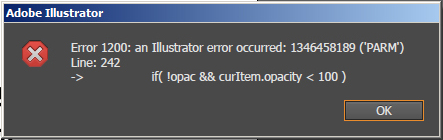

So this happen, I cycle through my artwork, compare their typename ono by one, and my script keep crushing.
Turns out there is often one or two pathItem's object tree property completely lose their mind.
No property, but error msg like this image, and this happens so often.

I'm running CC 19.2.0 (64-bit) on Windows 7.
This is the error I get every now and then. curItem is just a GroupItem object but all of it's properties are undefined, and then once I reopen, they are all fine and accessible again.
It's really inconsistent, if I simply reopen the file or cut and paste everything, the error goes away.

I think it was something along these lines that would cause problems
function temp() {
  var colorA = new RGBColor();
  colorA.red = 255;
  colorA.green = 0;
  color.blue = 0;
  var doc = app.activeDocument;
  var paths = doc.pathItems;
  for( var i = 0, ii = paths.length; i < ii; i++ ) {
    var curPath = paths;
    if( curPath.layer.visible && !curPath.layer.locked ) {
          curPath.fillColor = colorA;
temp();
Something like this would infrequently produce an error because all of curPath's properties would be undefined, like the screenshot I posted earlier.  Unfortunately I don't have a file where this would happen consistently because reopening the file would often fix the error.

I despise this error, one of my clients has just reported one of these to me.
Unfortunately it is probably happening in the middle of some complex task and copying/pasting may not even be a possible solution in their case.
Valorous Hero ,
Aug 23, 2016 Aug 23, 2016
I found this site and it has some interesting information:
http://exportkit.com/answers/why-do-i-see-parm-error-in-illustrator
This is why Illustrator crashes, it is a persistent system and it throws a core error. This causes the DOM to ”crash” and without a kill-recreate, its impossible to re-load the DOM without restarting Illustrator.
