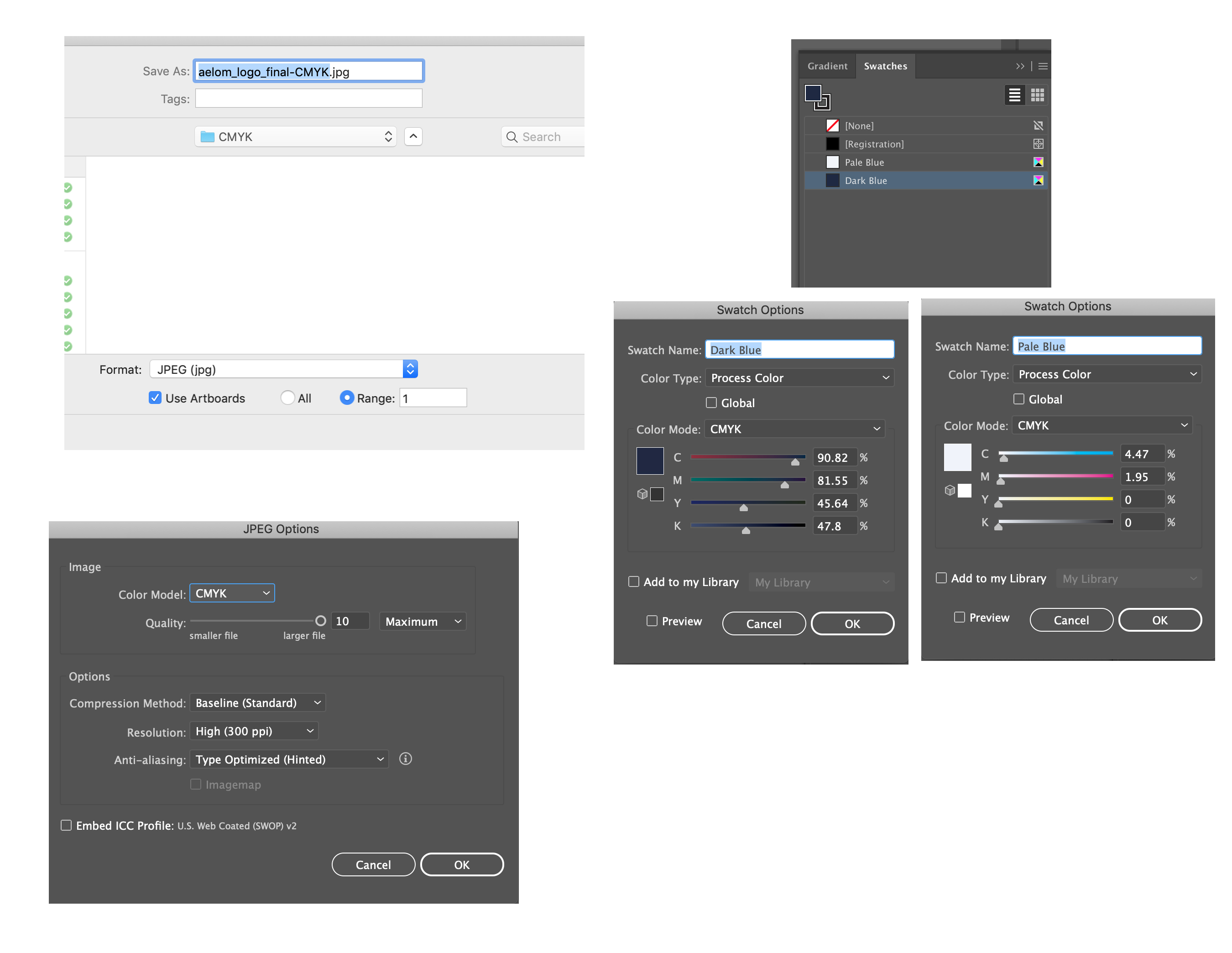

I am exporting a vector image, set to CMYK document color mode, to make a JPG. I am getting a huge color shift. It works fine for PDF and EPS. Any thoughts? I don't have spot color selected and the colors in my swatches are CMKY mix. THANK YOU!

can you show that color swatch so we can see that color you are applying?
Jan 16, 2019 Jan 16, 2019
You mention jpg but your screenshots show you are exporting out as a transparent PNG file. Two different formats...

oops. Yes I will show JPG export and color swatch. 3 min.
Community Beginner ,
Ok, here is the JPG export (apologies for the above) and my color palettes. I confirmed the JPG has the wonky color shift (so does the PNG but I suspect that is because PNGs are RGB always). THANK YOU ALL!!!!!

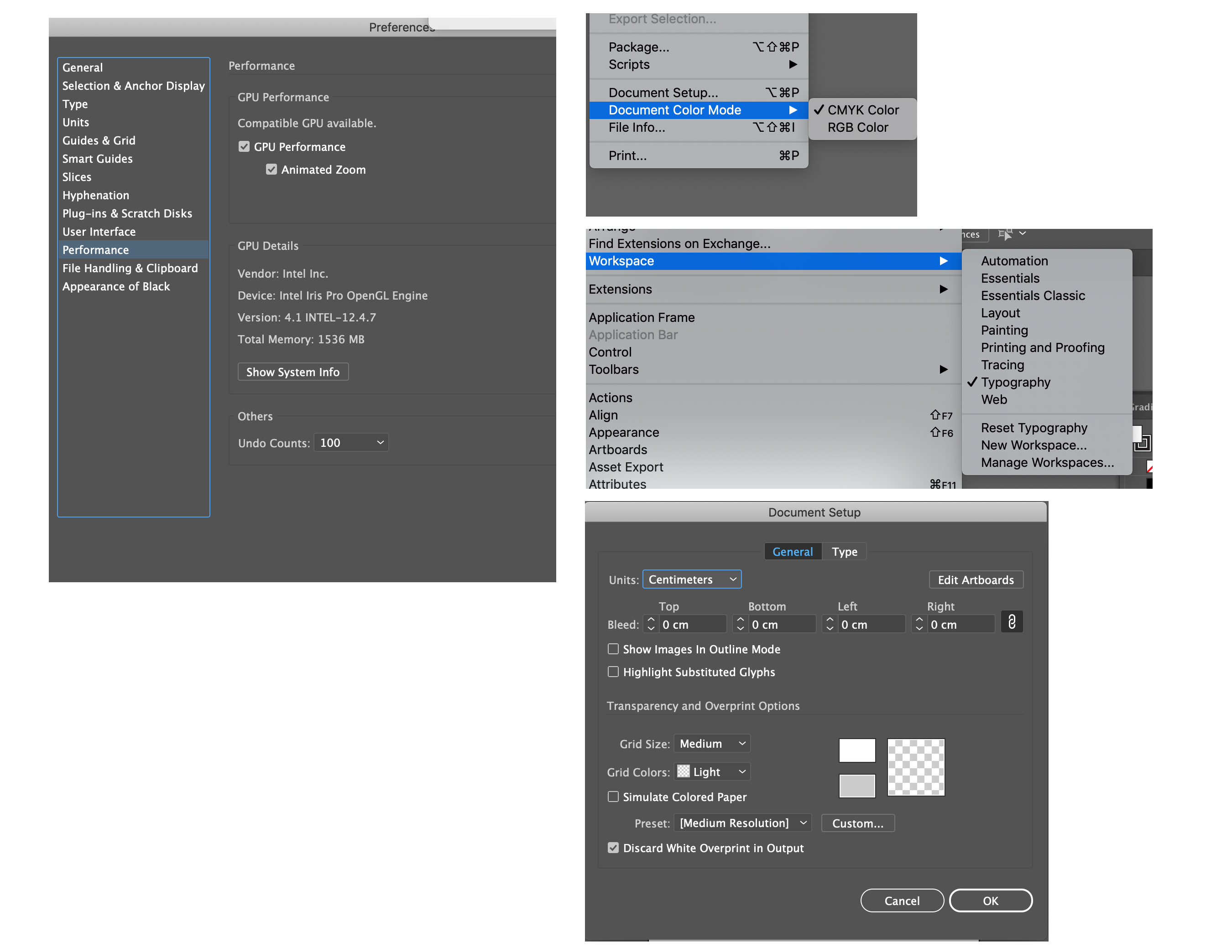

what is your color settings for your individual applications? Are you using the same color space?
CMYK - NA General Purpose, etc.
Here are my setting to the best of my understanding

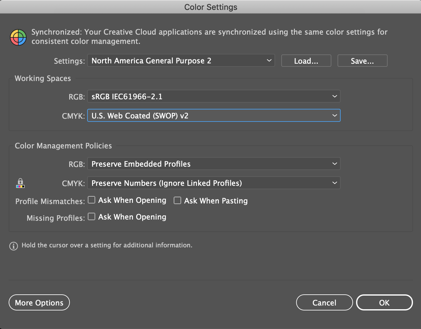

Go to Edit/Color Settings
Jan 17, 2019 Jan 17, 2019
Here's my color settings. Thank you!

thanks, I see that the Pale Blue (the problem color) is set to Overprint in the Attributes panel.
If you turn Overprint off the color shift goes away.
And I see the same logo 2 times on top of each other, does not seem nessecary to me.

It worked!!! And I removed the extra copy underneath that I did not know was there. Thank you!
