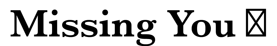

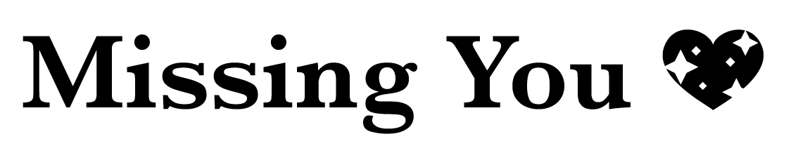

I routinely receive text strings that include emoji characters like this:
(this is the actual text but the heart does not appear after posting: Missing You   )
When pasted into Illustrator they look like this:
I'd like to convert the font character to "EmojiOne" automatically using Javascript:
Using Javascript, how do I test the string variable to see if it contains an emoji character then convert to "EmojiOne"?
Edit:
Interesting… When I paste directly into AI (not into a pre-formatted placeholder) the emoji converts automatically and the rest of the text is the default font,Myriad Pro. Cannot get it to paste consistently through.

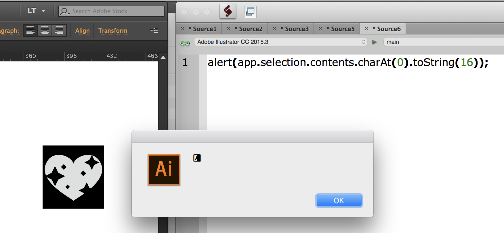

Jul 09, 2019 Jul 09, 2019
Emoji has two char codes, You can see below example.
These are High Surrogate and Low Surrogate code. ExtendScript can't phrase characters in this area correctly.
Probably, You can search High Surrogate and you'll get Emoji position.
LEGEND ,
Jul 10, 2019 Jul 10, 2019
Thanks for the explanation, Ten A. I'll see what I can come up with.
Edit:
The "alert" appears garbled when I run it from ESTK (Mac).

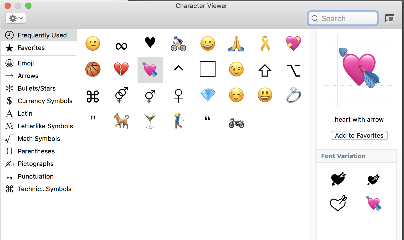

Jul 11, 2019 Jul 11, 2019
Most Emoji characters are allocated to the Unicode plane 1. However, Some characters allocated into Basic Multilingual Plane(Plane 0), You can see the below image.
These characters need individualized processing.

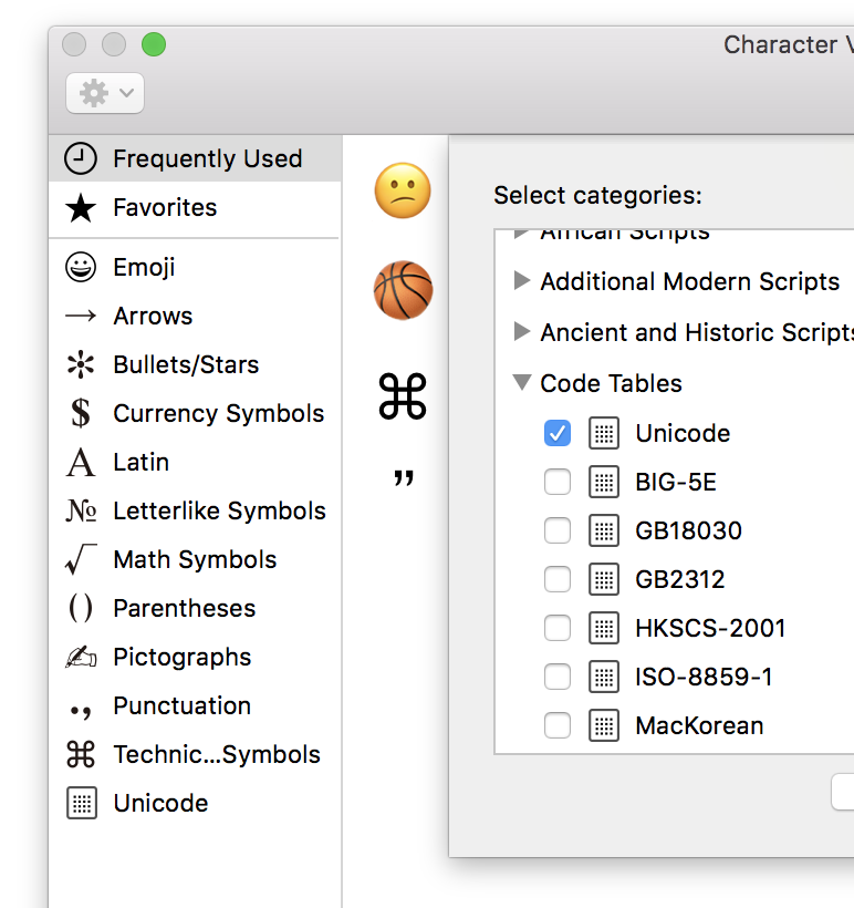

LEGEND ,
Jul 12, 2019 Jul 12, 2019
Funny, I don't see the "Unicode" option in my left column (Mac OS X 10.13.6).
Edit:
Found it… Had to "Customize" list:
