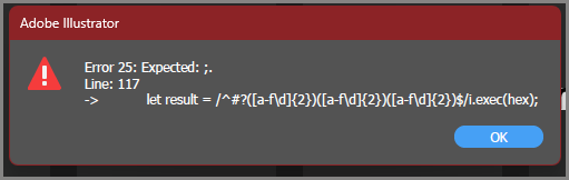

Hi there, appreciate your effort. Not so much looking for learning to code as my plate is somewhat full, but this seems very useful for an ongoing project. However Illustrator gives me error on Line: 117, expecting a semicolon, even though there seems to be one, suggestion for fix?

I fixed bugs in William's script and combined the automatic detection of rgb, cmyk and hex columns into one script. https://gist.github.com/creold/a605cd81a89e9884c384df1683c20654.
Direct download link (zip archive)
