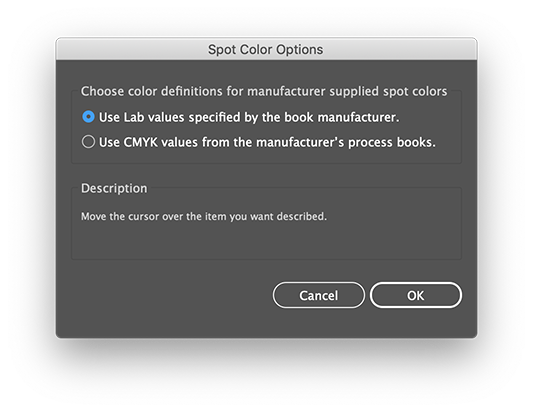

Mar 25, 2021 Mar 25, 2021
There is a option in the Swatch panel about spot colours, it does not seem to make a difference for me, but maybe it does for you.
And maybe a simple reset of the preferences will do the trick.
Community Beginner ,
Mar 29, 2021 Mar 29, 2021
Thanks for this, Ton. Appreciate the help.
Was fully expecting mine to be on the CMYK selection but nope, was on lab.
I have actually solved this since. Pantone got back to me and suggested that I hadn't exported the book in lab to Illustrator. I had but, what I hadn't realised is that the book export had failed. Colour Manager's notification of a failed export is quite well hidden. Still a bit confused as I swear this was working after the last time I updated my books and then switched to CMYK values recently - so a little confused. But to cut a long story short, after re-exporting the lab values from Colour Manager to Illustrator, I have solved the problem.
Seems quite an obvious thing to try now.
Thanks for all the help @Ton Frederiks and @Mike_Gondek
