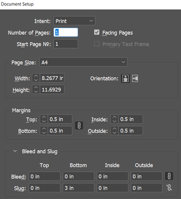

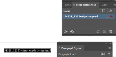

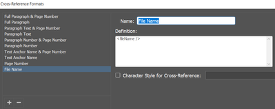

Here's a convulouted non-script way
Set your Slug area in File>Document Setup to be a larger size (larger than your bleed
Insert a Text Frame
And then insert a cross reference
This will pull the entire File Name.
Create a new character style and call it Filename (or something) and you don't have to do anything with this - just leave it plain and blank.
Create a New Paragraph Style for the text in the slug
in the white are is just a space
Create a New Text Variable
It will draw on first set of characters up to a space in your slug area - drawn from the cross reference - and inserted as a variable in the text above.
The only draw back is that I have to update the Cross Reference when resaving to a different file name.
Attached is a sample IDML file which should work.
https://www.dropbox.com/s/q8d6ueksuhd5a44/54321_123%20Design%20sample%20design.idml?dl=0
