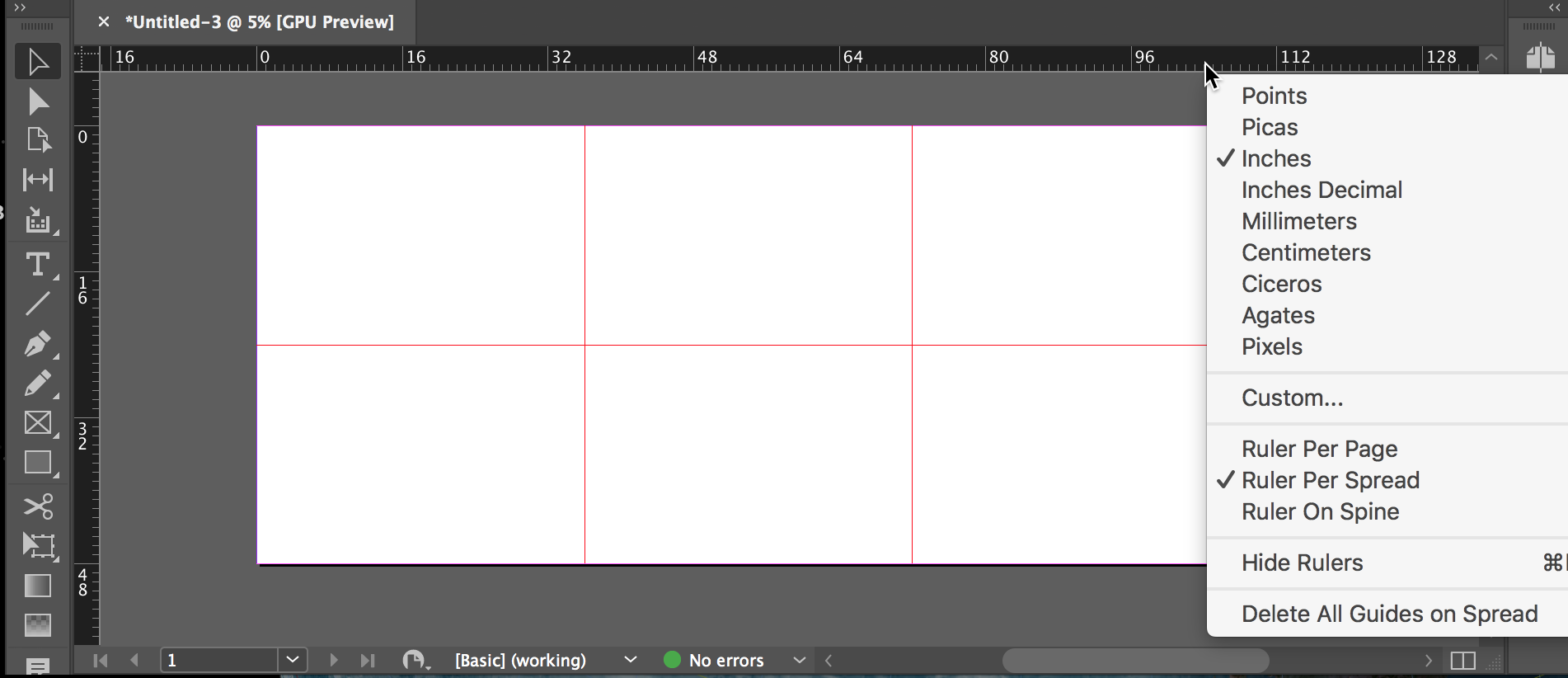

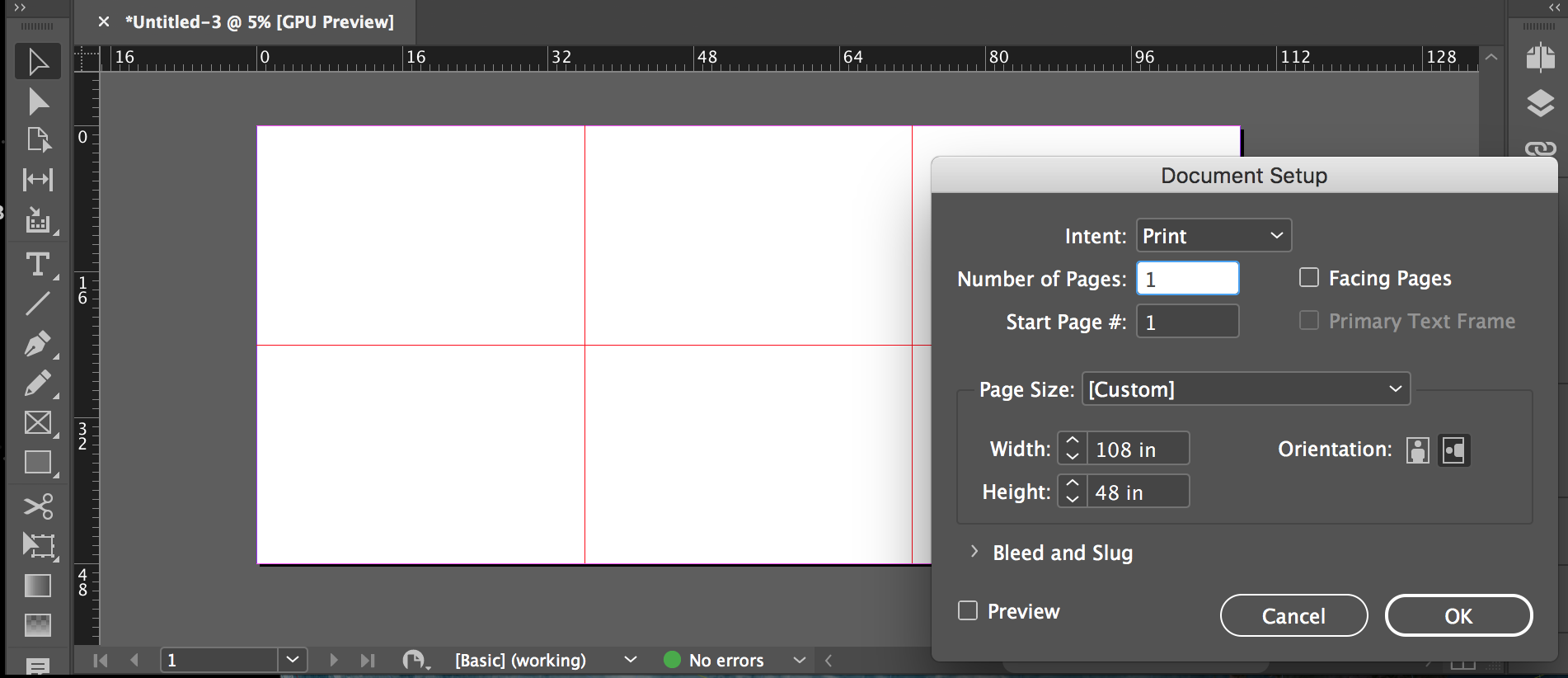

That doesn't seem difficult, unless I'm not understanding the requirements:

New Here ,
Mar 23, 2018 Mar 23, 2018
But this is one page divided by columns. Is there any way to make 6 separate pages look like this on my screen? While I can print this large size on a plotter, I’d rather have six separate pages.

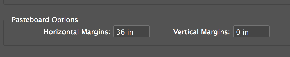

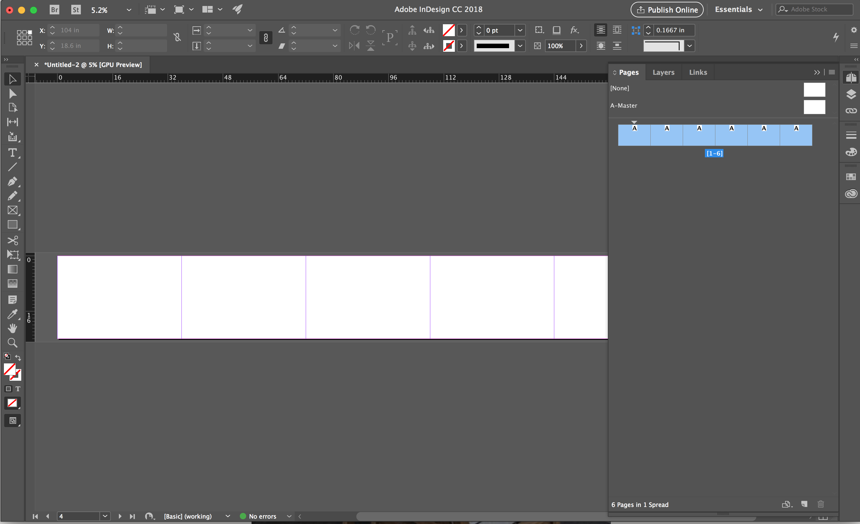

This as close as you can come: You can put the pages together in one spread by turning off the Shuffling behavior in the Page panel menu. But even when you set the Guides & Pasteboard preferences to 0 Vertical Margins, you can't have spreads next to each other—there's always a gap:

New Here ,
Thank you Steve! This should do the job.

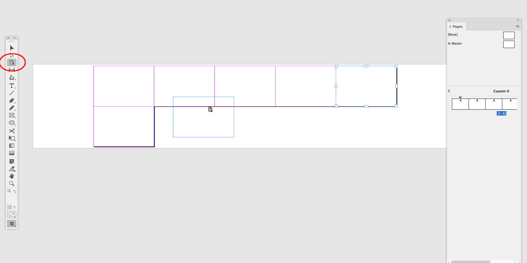

You can also arrange the 6 pages with the pages tool. If you do that you can crossover between the top and bottom row.
So set up your document with facing pages unchecked:
Uncheck Allow Selected Spread to Shuffle and arrange the 6 pages into a spread. And then with the Pages tool arrange the pages. Here you can see my cyan rectangle occupies all six pages.

Okay, I've arranged my 6 pages into a spread but I'm struggling to arrange the pages into 3x2. Where in the pages tool do I go? I don't know if this makes a difference (since I haven't used indesign on pc) but I'm using mac.

Mar 24, 2018 Mar 24, 2018
In the Tools panel select the Pages tool and you will be able to move the pages around on the pasteboard. You can also use the Transform panel to set a page's x,y position. This is OSX:

New Here ,
Thank you! This is EXACTLY what I was looking for.
