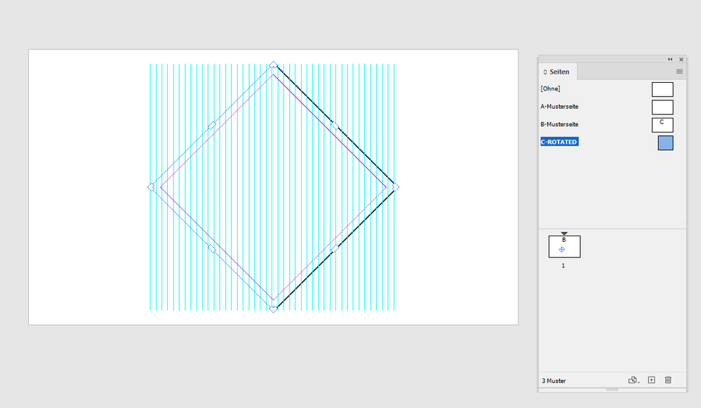

January 4, 2022
I know that is a rhetoric question.
FWIW: "Magnetism" is zero.
One could even use real guides in InDesign to do that.
On a parent page that is rotated to 45° and applied to the document page.
Even then: "Magnetism" is zero:
InDesign guides with zero magnetism, applied from a parent page that is rotated:

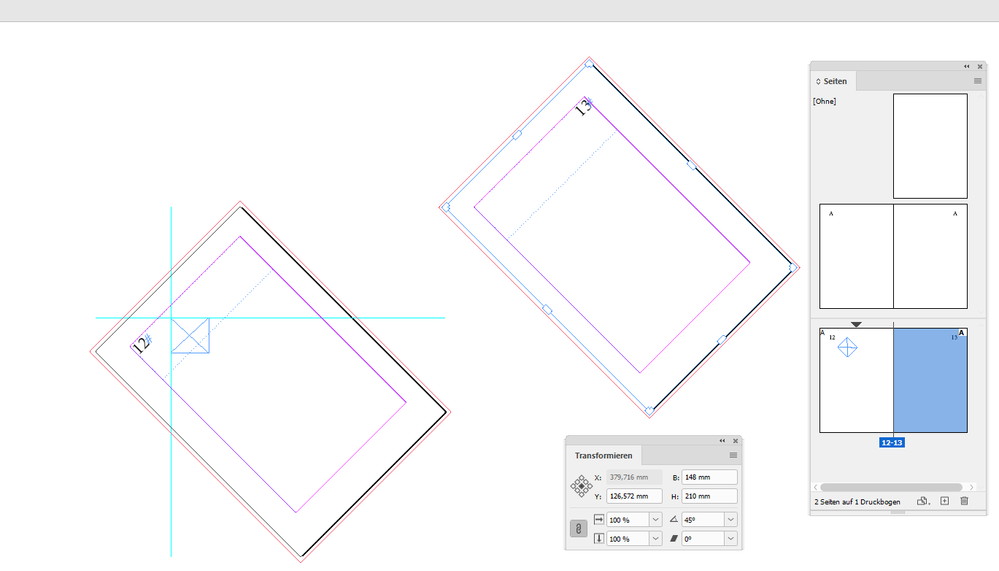

But this should work:
Rotate the document page and its contents to 45° and use normal InDesign guides.
Important note: To maintain the relative position of already rotated frames on the page while rotating the page itself, first group the contents of the page.
Select the page with the Page tool.
Rotate it with the Transform panel.
