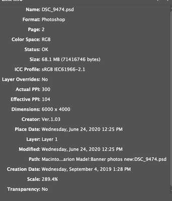

I tried your recommendation and it didn't work correctly for some reason. I imported the original .NEF file into Photoshop and saved it as a PSD file in RGB mode and then placed the PSD file in InDesign. It showed an effective PPI of 104 while the actual PPI is 300. Not sure what exactly is happening here.
I did experiment changing the resolution to 600 PPI and it was around 204 effective PPI in InDesign from the native PSD file but I'm hesitant to do that in fears of the photo file itself being grainy once it's printed.

Your screen capture shows that the image has been scaled up to 289,4%, so it is absolutely normal that the effective resolution goes down to 104 ppi.
