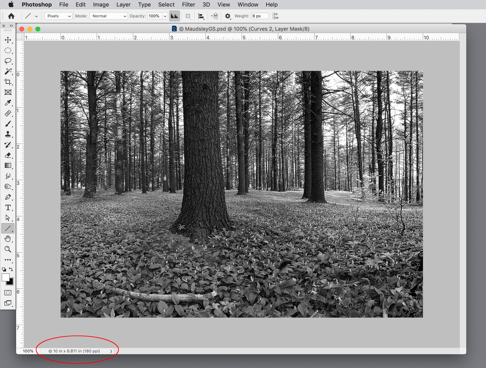

Hi @Parvathi24881399xiqs , Rather  than going to the extra work of resizing and saving in Photoshop, you could scale the image to 60% in InDesign, which will give you an Effective Resolution of 300ppi—the output resolution is the Effective, not Actual PPI.

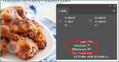

ID works with two PPI values — the native (and frankly arbitrary) value set in an image file, and the "effective" PPI as it's placed in InDesign. Frans touched on this, but if you have a file that is 1200x1200 pixels, and its (completely arbitrary) PPI is set to 300, then most apps will work with it at a nominal 100% size of 4 inches by 4 inches.
When placed in ID, if it's 4 inches square, both the file and "effective" PPI should be 300. However, if you place it at any other size within the layout, the effective PPI will change. At 5 inches by 5 inches, the file PPI (did I say that was an irrelevant value?) will still be 300, but ID wil be managing the image as if it is 300 * 4 / 5, or 275ppi. That's how ID will see the image for all output, rescaling, etc.
This 72ppi image is sized way down, resulting in a much higher effective PPI. See?

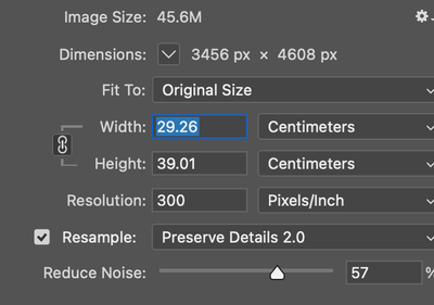

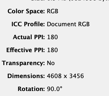

  See the dimensions are exactly the same. I've not donw anything, just opened the same image in photoshop and indesign. I understand the difference between actual and effective ppi. But please see my screenshots. Even with the dimensions being the same and placing the file at 100%in indesign, the photoshop resolution is 300 while the indesign one is 180.

I've just experimented with both apps and a wide variety of images, and have found no discrepancies. I am betting that something in PS is misrepresenting the value, perhaps a standard conversion value rather than the actual. Look at the PS Info panel, and (maybe even more baseline-level) in the actual file folder, right-click and check the file values directly.

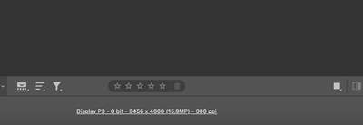

I've also set my images to open on Camera raw first in PS, see it shows as 300 in camera raw also. But 180 in bridge and indesign

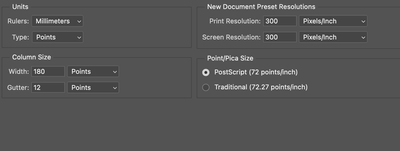

no the photoshop screenshot is just the normal image size window. And the PS preference I'm talking about is this.

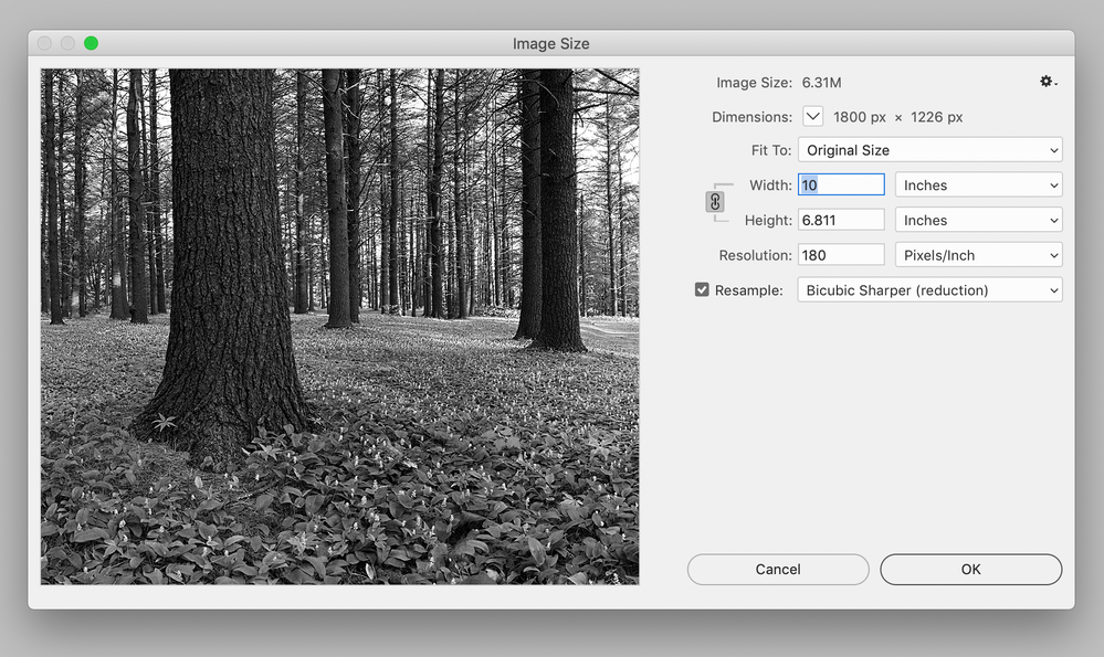

Open the file via Photoshop’s File>Open... then check Image>Image Size..., which will give you the actual output dimensions and resolution:

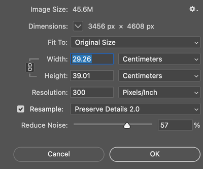

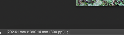

I have tried all of the above. The files i place in indesign are jpegs or tiffs only. Not raw files. Please see this scrrenshot of my bottom left screen and the image>image size screen
. I've opened the image on photoshop via, PS>open>image name. It still shows as 300ppi. But the original image on my Mac preview, bridge , indesign everywhere is only 180.
Do i conclude now that this is a glitch?
