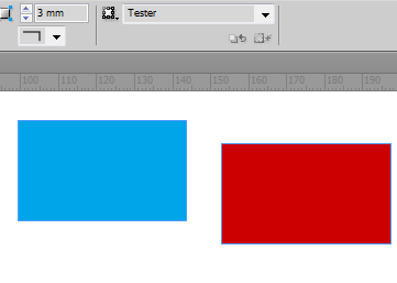

I want to use the align top function on 2 objects - but I don't necessarily want them to align to the topmost object.  In other software, it depends on the order of the selection as to which object the two will align to but this doesn't seem to make a difference in indesign
Picture for an example, I want both objects to align to the top line of the square on the right, not the left ie the square on the left should move down
Is there a way?

Here's a 'live' demo. The first try is a 'default' behavior, the second one - what you need:
Mentor ,
Oct 21, 2017 Oct 21, 2017
Select both, then click on the right object repeatedly. It will get bold outline - that means it is a 'reference' object now. Apply alignment.
Community Beginner ,
AMAZING!!!  Thanks so much, I should have asked ages ago
